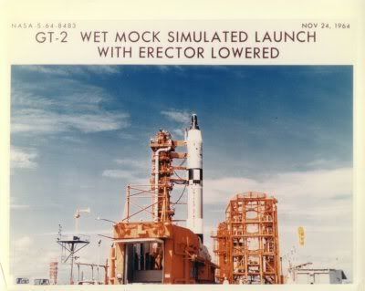

I've noticed in numerous pictures of Pad 19 during the Gemini years that there appeared to be another, lower "stand" next to (just east) of the umbilical tower and this stand looked like it was designed to have a rocket sitting on it. Reading the book "Go For Launch" they state the Martin guys could static fire a Titan II second stage and I believe they intimated it would be fired on this stand. Is this true? If so, there must have been another flame bucket below that stand, correct? This is pretty cool if true and I'd love to see some pictures of that setup, especially in use (if it ever was). Thanks for any insight.Harvey Brown |

Harvey, you are absolutely correct. There was a separate Erector, Umbilical tower and flame bucket appropriately sized to allow static firing of Stage 2 prior to erecting the entire vehicle onto the launch stand. Tom |

It is true. At or about the time of GT-3 they tore the second unbilical tower down. That tower was quite a bit smaller, I use to have photos of it and the second flame bucket, and maybe the second stage being tested. Will have to check. |

FYI, in the new Spacecraft Films DVD set containing the Manned Spacecraft Center reports from 1964-1969, there is footage of test firing both stages side-by-side of the Titan II at Pad 19. It was a sequential firing, with the first stage firing, then the second stage immediately following.Here is a photo showing the second umbilical tower in place. |
