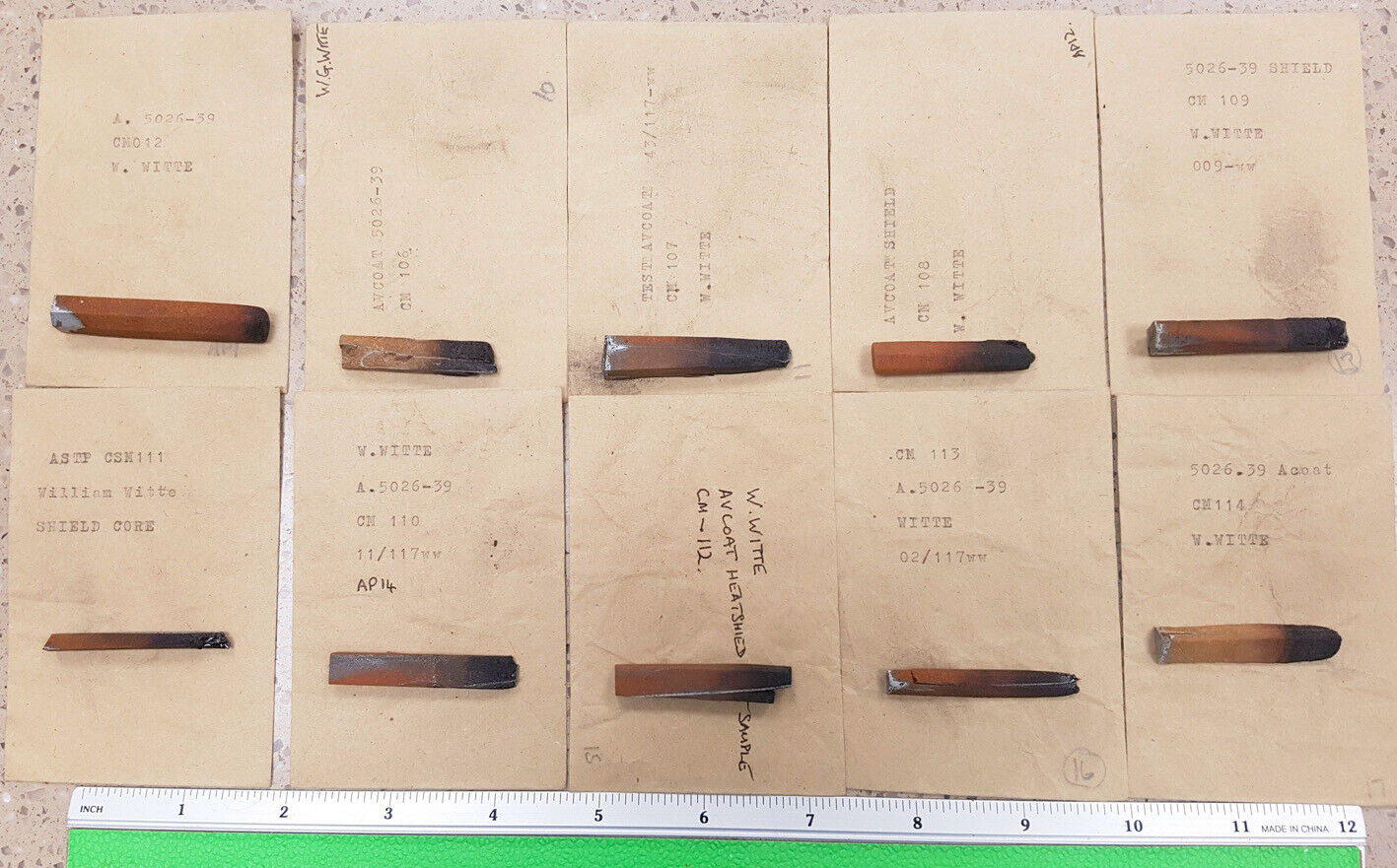

There is a sale of heat shields from every Apollo mission. However, I am perplexed by the Apollo One sample, as it shows charring. I thought the Apollo fire happened mostly inside capsule, so how can there be charring outside as shown by Apollo One specimen? Any insight will be welcome. Thank you. This set was owned by a NASA employee, Mr. William G Witte. They are all in their original annotated envelopes. They were each a part of cores taken from the command modules for post flight testing.  |

Not every mission it appears. In short - the segment is not from the Apollo 1 CM, not only for the reason you noted but also because conditions for ablation of the heatshield were absent during the incident. As a result, confidence that the other samples are correctly aligned to their descriptive cards is decreased. |

The Apollo 1 specimen is the top left one, and it seems to show much less charring than the others. I wonder if that supports correct mission? Putting aside the Apollo 1 issue, I wonder what people think of the significance of the collection, i.e. is it possible that these are flown ones? The envelopes suggest so. And the name on the envelope, Mr. Witte has written a paper on Apollo heatshields, and in it, he is described as a NASA engineer. |

As Apollo 1 never flew there should be zero charring on that sample. Again as with so many items that surface it is hard to prove that any of these samples go with the card shown, moreover that they flew on a manned mission at all. I have a nice Apollo heat shield sample from an unknown mission but most likely unmanned. Think of how easy it would be to cut it up and claim manned mission flown status. It is easy to assume a sample flew or that these samples are on the correct cards but I do not think you could ever know for sure. |

quote: Originally posted by Chuckster01: As Apollo 1 never flew there should be zero charring on that sample.
The Apollo 1 investigation board's report does state (and illustrate through photographs) that there was charring to parts of the aft heat shield as a result of "high temperatures and high velocity gas flow." That said, the report does not provide enough detail to make any conclusions about the auction sample, nor does the auction include enough detail to know where the sample originated. |

High temp/high velocity flow was documented to occur between the headshield (i.e. inboard side) and the cabin structure. The segment in the listing is externally ablated. |

In one photo on the auction listing it shows the 10 little cards arranged in a circle without the charred splinters, so they are apparently not attached. Whaaaat? The alleged Apollo 11 card states "TEST AV COAT 43/117-ww" whatever that means. Thought about clicking "Make an Offer" for ten bucks but seller does not accept PayPal and will not ship to the USA. Go figure. |

According to the lot description, the "cards" are envelopes, so the photo of them arranged in a circle could be with each piece still inside. Even unflown and poorly documented Apollo heat shield samples would be worth well more than $10. |

Looking at the images, the material appears to have been burnt after it was cut. This could be because they were tests after sectioning, or that they are not what is advertised. |

I have bought similar items to what is shown in images from the seller. They are Apollo 11 shields. The pieces I have are not regular so very unlikely to be test samples, where one would have expected them to be perfectly shaped. The seller of these pieces is a very well known ex-collector who I am sure many of you know. However, I do not have his permission to reveal his name here. I am not the seller of the above items. The Apollo 1 piece is very intriguing. The NASA report on Apollo 1 does show an image of ablation on an area of the heatshield. But that part shown is the forward heatshield, not the aft (lower) heatshield. Now the piece shown is about two inches long, which means that it is from the lower aft heatshield, as it is only the aft heatshield that was this thick. So how did aft heatshield have charring? It is quite possible that I did not read the full report correctly. I have sent a message to heatshield experts at NASA, but not sure if they will reply. Interestingly, The Space Store has sold pens having shield material got from William Witte, the name on the envelopes. |

I would be curious to know what temperature AVcoat chars, what type of equipment was used to conduct testing, and what shape the test samples would need to be to provide consistent, repeatable results between samples.I would also be curious about the silver paint, and why paint is on the sides of the samples that should not have painted surfaces. |

Please Google Apollo heatshield testing. There were some NASA documents, which I do not seem to find on my computer. They have pictures of samples. I had another look at one of my pieces from a collection similar to one on sale. On closer look I can see, at one side of piece is part of the honey comb matrix into which the heat shield material was pored into. Also there is a impression of a hole in the lower part of the honeycomb matrix, which I think is the air hole. They filled about 360,000 cells by hand. I think these holes allowed air to escape as they filled the honeycombs. I think the seller has shown the "good" side of the pieces. Actually, it is the "not good" rough part, at least in my piece, that shows all the interesting stuff. |

quote: Originally posted by oly: I wold be curious to know what temperature AVcoat chars...
Collective function of pressure, temperature and ratio/partial pressure of gases in proximity with the material (at the low end its a couple of thousand degrees over a sustained period). quote: I would also be curious about the silver paint...
The "silver paint" is actually the bonded interface to the stainless substructure onto which the AVCOAT was applied. |

Believe most plausible scenario is that several of the cards (from other missions) and associated/comingled samples are missing. Given Witte's role and direct access to ablative materials its likely most of the samples are legit but misaligned with their respective index cards. Witte also flew AVCOAT samples on unmanned (non Apollo) payloads so the complete inventory may have even included other source material which became interchanged with manned segments once departing Witte's custody. |
