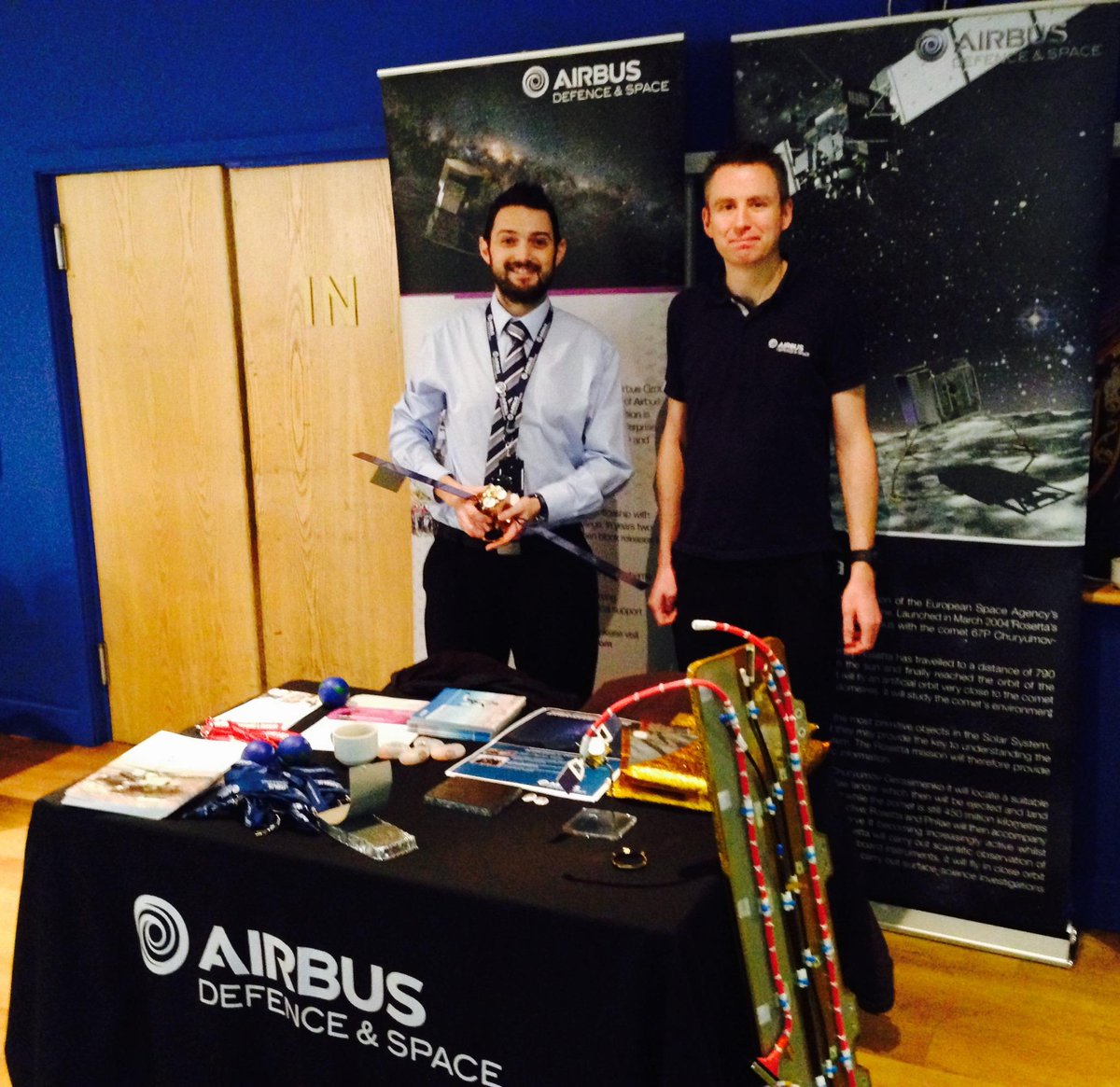

I posted a photo on my twitter a little while ago (12th Feb) at an event where I had one of these panels (me in the tie).The panel leaning on the table has all of the elements in your hardware, aluminium panel, wiring, connectors, kapton, inserts and heater. This is a flight article from a satellite that we now use for STEM events.  |

Thank you, John. The panel on your table does resemble the one I have, although mine seems to be considerably thicker.The pieces I am asking about came with an artwork that bears the signatures of several individuals that I think had something to do with the Mir mission. I wonder if it is possible to identify the autographs? Maybe that might help tracing back the history of the artefacts?  |

That's an interesting piece. I don't know anything about it, but I like it, and I can't say why!By the way, the panels do come in thicker cross-sections. I will get some better photos for you when I'm back in work. |
