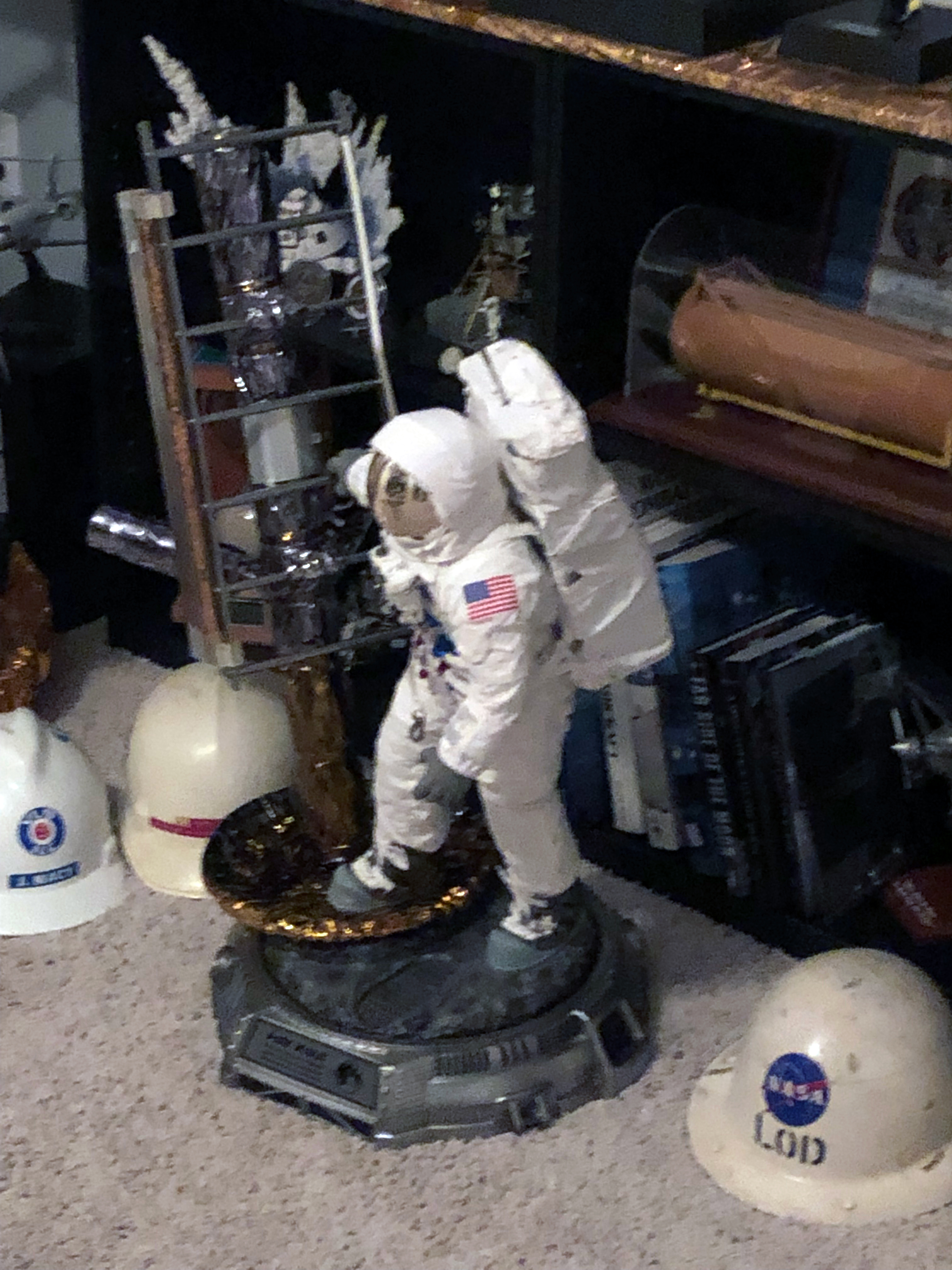

And now let's try it with the latch closed.

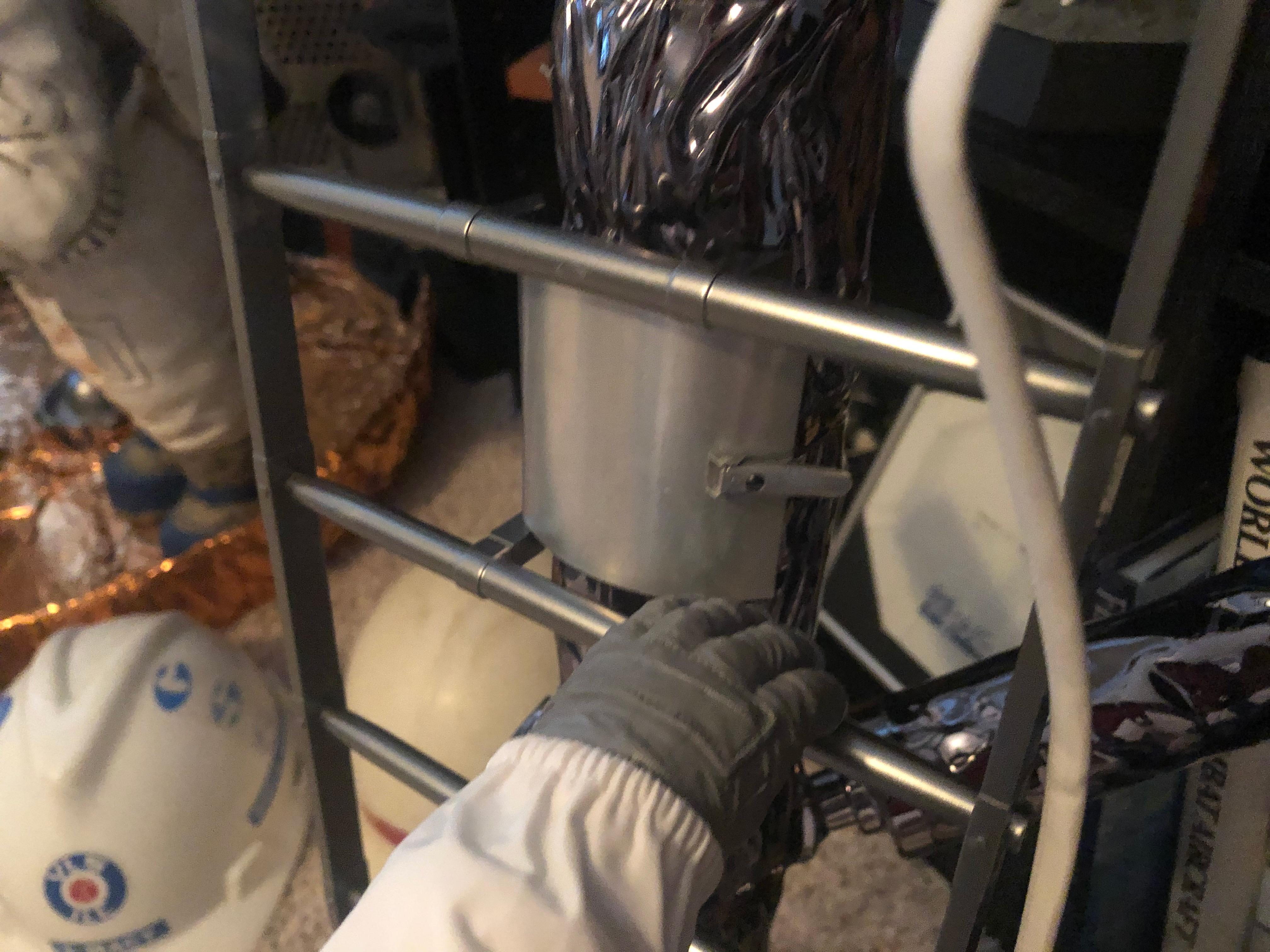

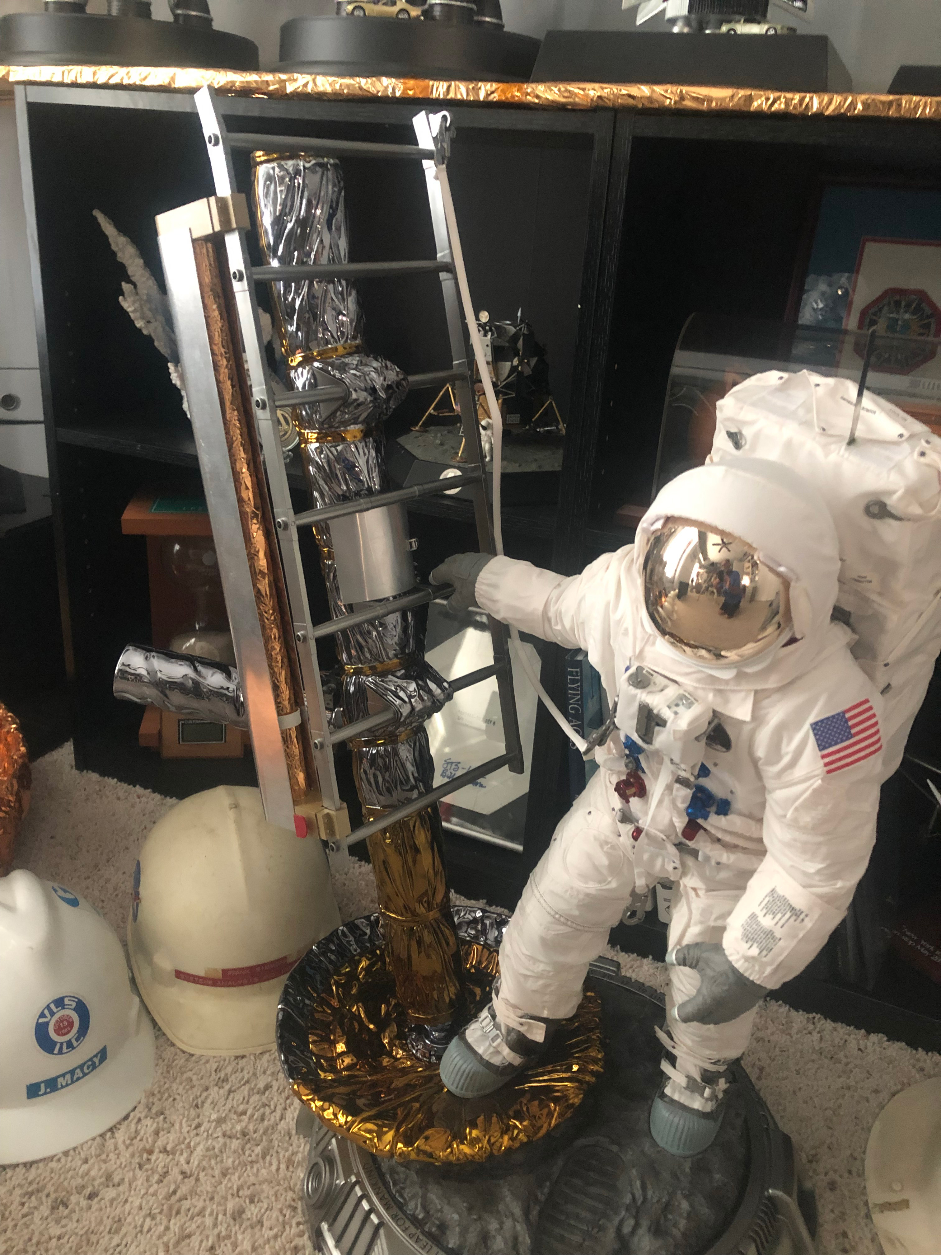

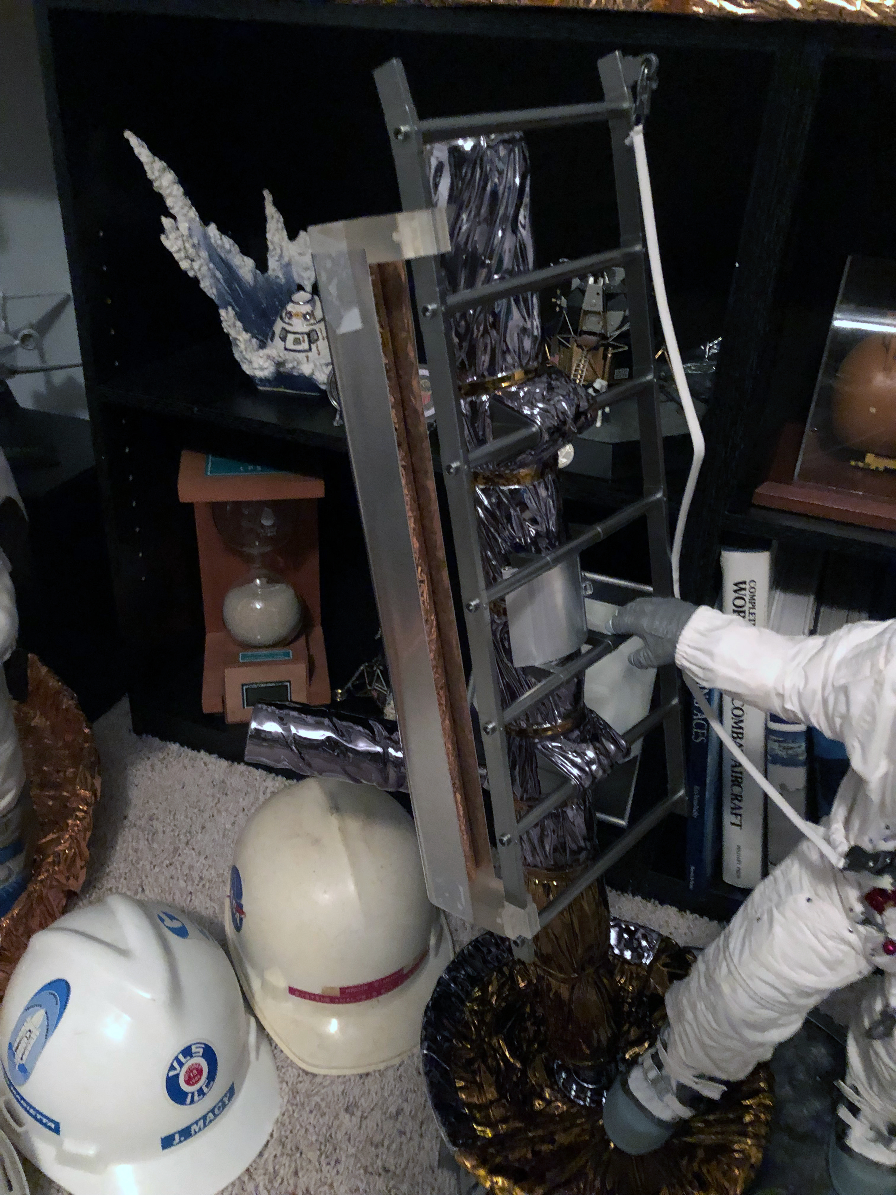

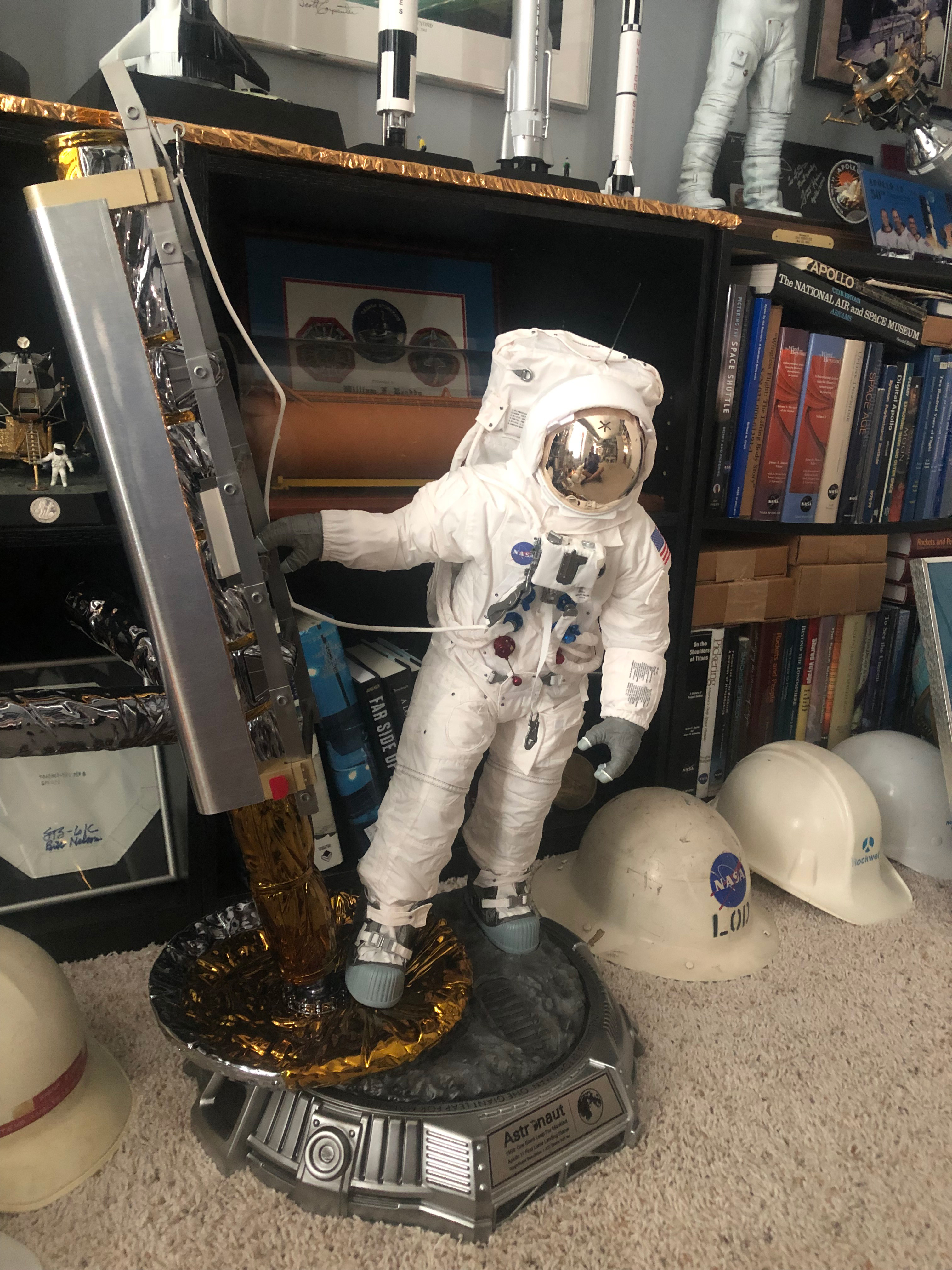

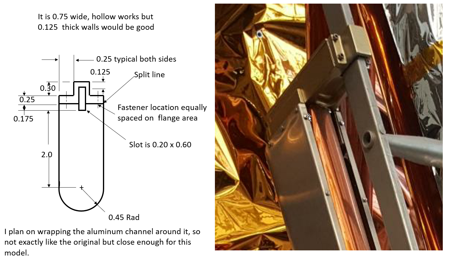

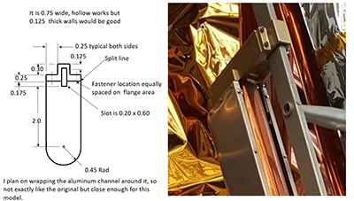

After a slowdown in my ability to work on the flag holder upgrade to this model I have check fit the assemblies I have. Big thanks to Michael Key who produced the end fitting (a two part assembly) based on my rudimentary drawing. Fit up looks good so far. I used 0.025 thick aluminum I obtained from Lowes. Using a dowel, I formed it into shape and trimmed to size. I then used the same dowel wrapped in a mylar blanket piece to look like the wrapped flag. The end fittings need paint and there are some details I need to work out like a red button at the lower end. More to come but as some have asked I wanted to post a progress report.
GACspaceguy Member Posts: 2864 From: Guyton, GA Registered: Jan 2006
posted 08-13-2022 06:36 PM
All done! Painted the end fittings, added the red release button and depicted the white pull for what I believe allowed the astronaut to grab and pull out the rolled up protected flag.
