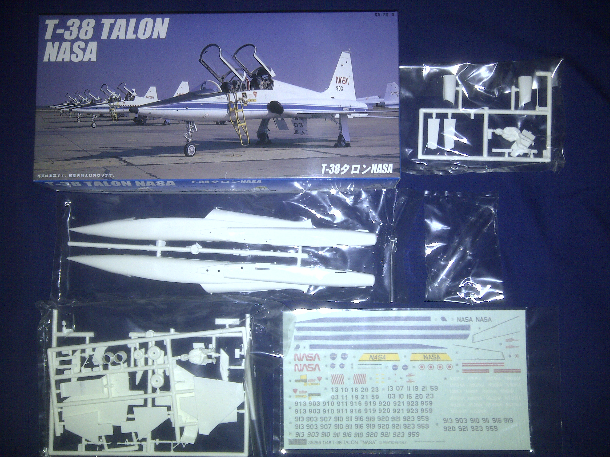

A couple of days ago I received two 1:48 Fujimi "NASA T-38" kits, purchased through HobbyLink Japan.My out of the box impressions:  Calling this kit "basic" is somewhat like saying collectSPACE modelers do details: Both statements are correct, but barely adequate. First of all, the box art is misleading. It shows a photo of the actual aircraft with canopies open and airbrakes down, neither of which is an option with the kit save major mods and scratch-building that I'm not nearly up to. Second, there is literally NO cockpit detail. None. The kit doesn't even include a cursory instrument panel. I wasn't planning on modeling the crew figures (who at least appear to scale), but I now realize that if I don't, I can either black-out the cockpit entirely or build something that looks like the Disney World NASA Jet Experience. So my biggest challenge won't be the plane but the pilots. Awesome. Anyway, these kits cost me about US $20.00 each, so with paints, glue, and brushes this has turned into a cheap weekend re-visitation of my youth. I bought two of these things reasoning that with shipping from Japan it was cost-effective, and if I made a botch of the first I could still pay someone who knows what they're doing to turn the second into something presentable. Now I'm not sure that an actual skilled modeler wouldn't be insulted by the proposition. As it is, the finished model(s) will likely just be placeholders in my collection until better options hopefully come along. I'll post the results of my efforts; good, bad, or ugly. |

For T-38 fans, right now your best options are the Sword kits in both 1/72 and 1/48, but Kinetic is working on full injection tooling kits of the F-5B in 1/48. I had heard the T-38 is also going to be part of the list and others have said the T-38 is coming first, but I haven't confirmed that. If Kinetic is indeed doing a proper T-38, it will be a very good thing. Fujimi's kit of the T-38 indeed is a T-38, but it is OLD, of course has practically no cockpit detail and it is actually 1/50 scale instead of 1/48.Sword's kits of the T-38 are not bad at all and indeed the best for that model out there. But they are a combination of styrene, resin and photo etch and not the easiest to build. They have been OOP for a couple years, but still are easy enough to find at some shops and indeed on eBay. Collectaire models did an all resin T-38 in 1/32 scale, but they were EXPENSIVE when issued and are probably more so today if you find somebody willing to part with one. Now concerning NASA's T-38 fleet, how accurate the T-38 kits are will depend on which T-38 you are building as NASA has made a few changes to the fleet over the years. In the 1970s and much of the 80s, the NASA T-38s except for the paintjob were the same as the Air Force ones except for maybe some radio equipment loadouts. The first change made was to the ejection seat as the original Northrop seats were replaced with Martin Baker US16LN seats starting in the mid-1990s I believe. Reason this was done is NASA has astronauts and crew members who are of different builds than typical USAF pilots (such as women astronauts of lighter build and weight). Prior to the new seats, light weight crew members had to wear ballast bags when they strapped in, otherwise the force of the ejection might cause back injuries. The extra ballast was needed to counteract the shock of the ejection. Many of the planes were retrofitted with color weather radar at the same time they got the new seats, but there was a mix of T-38s in the NASA fleet with radar and without. Except for the black nose, the biggest change this brought about by the radar installation was the instrument panel as I believe both the front and rear panels have a radar display in the center. The new sub-sonic intakes didn't start getting added to the fleet until about 2004-05 and although it is intended to be a fleet wide upgrade, I don't believe all the jets have that yet since NASA's small budget means they only do the upgrade when the planes are due for major checks. The conclusion of course is if you plan to do a T-38 from the 1960s thru the late 1980s, assuming you start with an accurate T-38 kit you should be fine. If you want to build a more recent one, then things get a bit tricky. As for decals, I have the VM sets as well and I am not crazy about them (the font he used was not bold enough for several of the markings). I am pretty sure if Kinetic is doing a T-38, better decals should be along soon. The only other sheet I've seen for NASA T-38s is a sheet Microscale did in 1/72 scale for NASA T-38s from the 1970s. |
