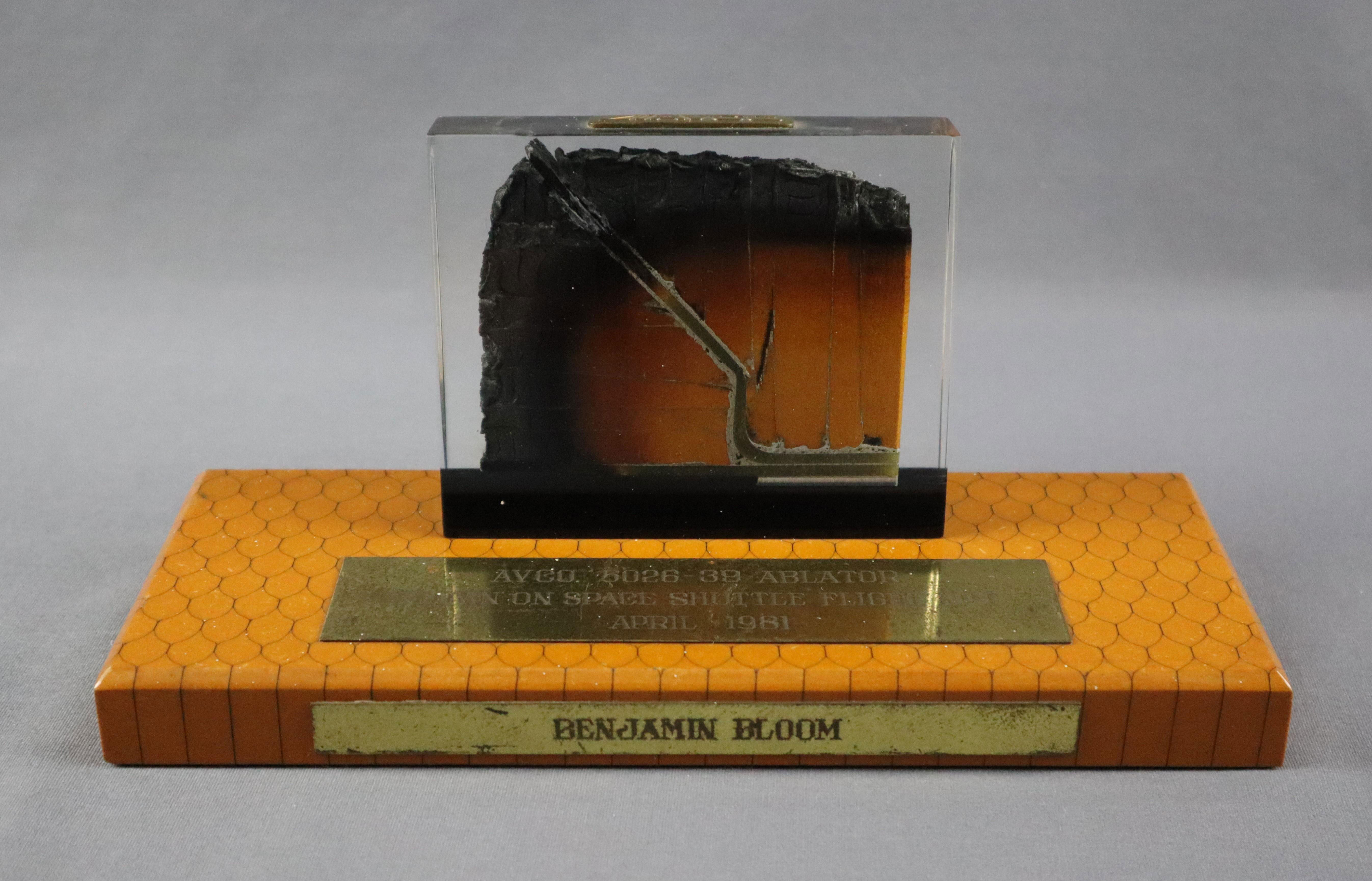

I had been watching this now closed eBay auction (121880428499): AVCO 5026-39 ABLATOR (Heat Shield) Desk Model. It sold today for $356.79.
What intrigued me about this desk set with an acrylic-encased sample of Avcoat heat shield was what was written on the plaque:
AVCO 5026-39 Ablator
Flown on Space Shuttle Flight No. 1
April 1981
I was in touch with the seller because to my knowledge (and the best of my searches), such an ablator was not part of the space shuttle's thermal protection system.
I asked if perhaps the desk set had been repaired or if the plaque had been added in the time since it was presented, but he said that to his knowledge, it was exactly how his father received it 35 years ago.
I checked the STS-1 Official Flight Kit manifest to see if perhaps a commemorative sample had been flown, but there was no such listing. I suppose it could have been part of Young's or Crippen's PPKs (Young would make some sense, I guess, given his Apollo history), but there is no indication of that, if that was the case.
I did not bid on the auction, but can anyone shed light on how an Avcoat ablator sample ended up on Columbia — if indeed it did?

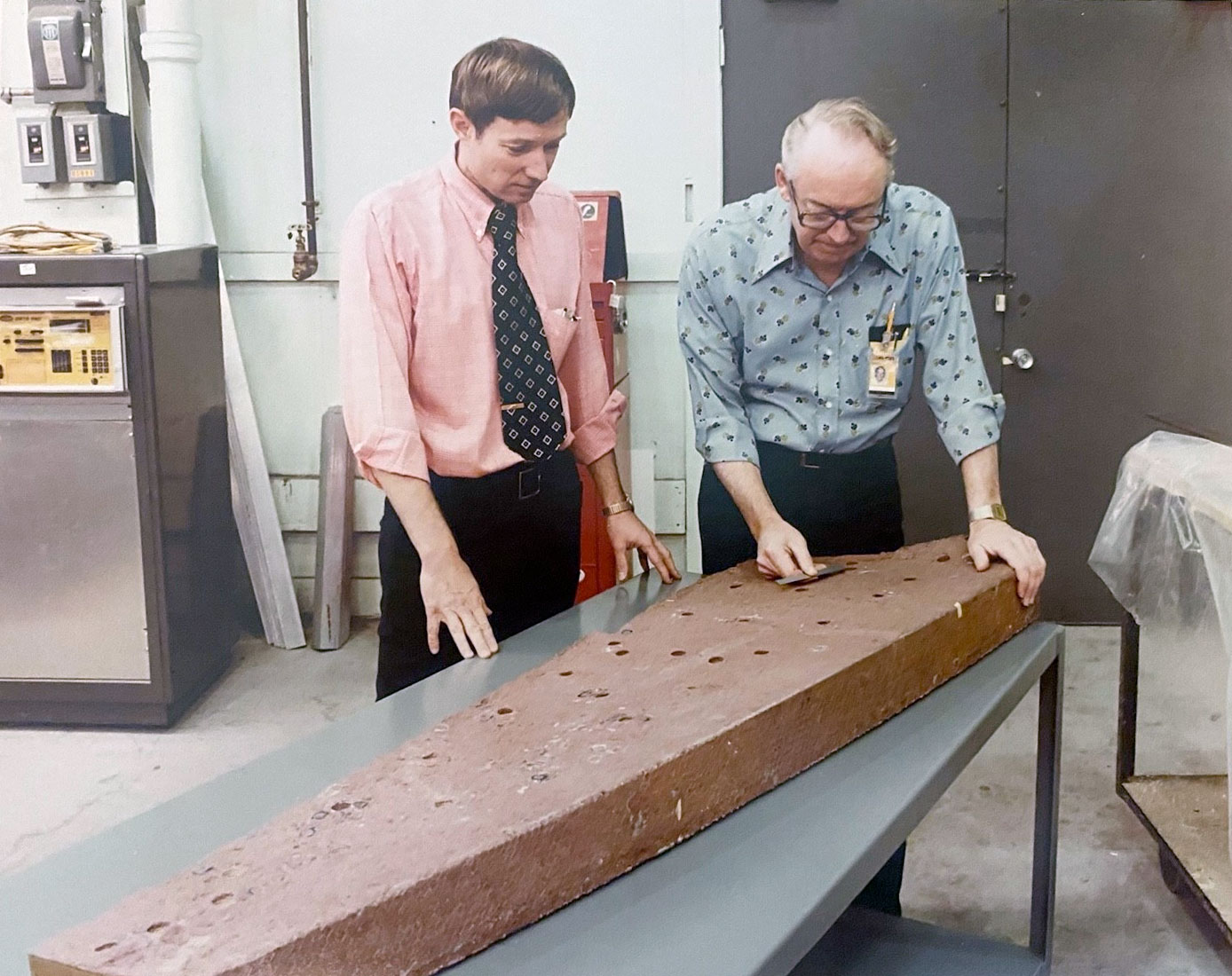

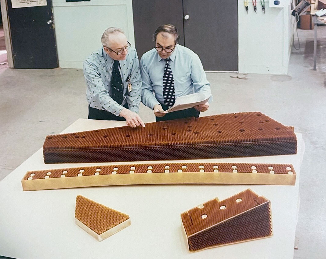

Resurrecting thread since its last reply nine years ago because another of the displays that began this topic has popped up on eBay (306329414036) together with some photos that help put the original use in context:

Ablator depth in the accompanying images is interesting; Apollo CM required protection against lunar return velocities yet maximum thickness was under three inches.
Perhaps in the case of STS application AVCO elected to employ a more robust design to account for dynamic loading (rather than thermal considerations) as total vehicle mass was less of factor.
