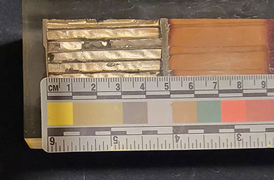

SpaceAholic Member Posts: 5366 From: Sierra Vista, Arizona Registered: Nov 1999
posted 06-20-2024 09:24 PM
Apolloman Member Posts: 231 From: Ledignan, Gard (30), France Registered: Mar 2009
posted 06-21-2024 01:00 PM

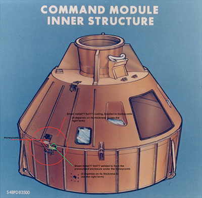

Thank you, but what you're showing us here (if I'm not mistaken), while still interesting, is only the complete structure of the heat shield and not that of the pressurized inner structure (crew compartment).You can see the stainless steel parts (which were brazed rather than bonded, as in the crew compartment's internal structure) and the ablator-filled honeycomb. On a previous post I had opened, you had even given me the thickness of the sheet metal (sheet metal because 1,90 mm thick) used with a caliper. Thanks for the effort. I'm looking for this (maybe a drawing will help me make myself understood):  |
