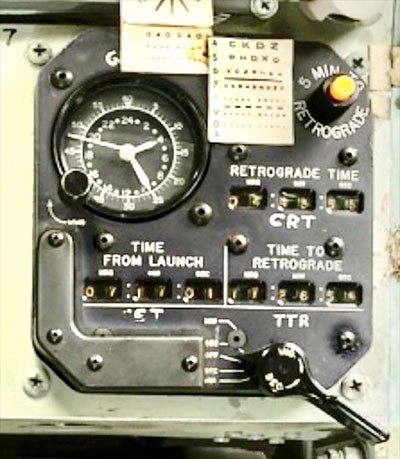

This is the best I could find for you, zooming in and enhancing from this amazing National Air and Space Museum photo from Friendship 7: |

Sharper, but cropped, from here.  | |
