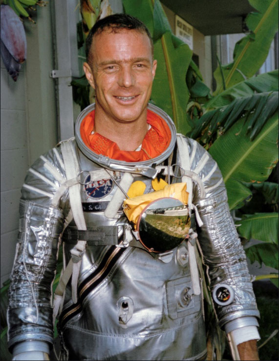

The Mercury spacesuit neck ring was fitted with a water blocking neck dam that the astronaut could pull closed over his neck in the event that the astronaut had to jump in the ocean during spacecraft recovery. Does anyone know how the neck dam was worn or accessed?
The first picture shows the neck ring and fabric interior of Scott Carpenter's suit with no visible trace of a neck dam stored or retracted within the dimensions of the neck ring. And the second picture shows Carpenter during water recovery training adjusting a neck dam. This makes me wonder if the neck dam was pulled over the head or whether it was in a retracted position and then pulled into place to surround the neck.
When Gus Grissom had to jump in the ocean as his Mercury capsule was sinking, he was able to pull into place a neck dam. So it remains unclear to me how the neck dam was accessed.
Was the neck dam stored in a pocket on the Mercury suit and taken out when needed?

The first picture does in fact show the neck dam in its stowed position on the outside of the neckring with its protective cover in place.

I am not seeing what you are seeing. Can you point out on the first photograph where the neck dam is stored or what color the protective cover is?
I see below the neck ring two yellow packets behind the mirror mounted on Carpenter's chest. The first yellow packet I believe is a life raft and the second packet that has a 'U' shape I believe is a life preserver that goes around the chest and under the astronaut's arms. And in the second photograph, Carpenter has released both packets and has the life preserver inflated and underneath his arms. Or am I mistaken about that and the yellow packets only contain the life preserver and a life raft is carried separately.
The life preserver was added to the Mercury suits after Grissom's water recovery experience. But as I recall, Grissom did have a neck dam on his suit.

In the color photo, I think the silver tab and tube just to the right of the NASA patch is the beginning of the stowed neck dam, which wraps around the outside of the helmet ring below its lip. In the b/w photo the helmet ring is dark after the dam has been deployed.
This photo also shows the stowed neck dam.
I could be wrong though.

As Robert identified in his post, the Mercury suit neck dam was attached to the outside of the neck ring in the flat area just below the rotating latch ring. It was rolled-up/folded-up and covered with a narrow strip of aluminized suit fabric with the ends secured together by a snap. You can see the end of the fabric strip and the securing snap in the first photo (center of the front of the neck ring just above the yellow life preserver pouch).
The neck dam was part of the flight-ready pressure suit, so it was not "donned" separately. It was deployed when needed and would be virtually impossible to roll back up once deployed, especially with the suit on.
MR-4 mission photos clearly show Grissom deployed the neck dam. His suit was most likely swamped by water entering thru the abdomen oxygen hose attachment port. The early suits had a outer hinged flap/door that was secured once the hose was disconnected. Later suits had an internal self closing valve that automatically sealed when the hose was disconnected.

I have a related question which is after Grissom's flight, astronauts on all the remaining Mercury missions wore a yellow packet on their chest that was positioned behind the mirror (see first picture in this post). When deployed did this yellow packet release a life raft or a 'U' shaped life preserver that fitted under the astronaut's arms?
In the first picture in this posting, one can see the 'U' shaped life preserver stored on Carpenter's chest. What struck me about this is this is the first picture I have seen of the 'U' shaped life preserver exposed on an astronaut's chest while it is still in a stowed position. With all other Mercury astronauts I have just seen the yellow packet neatly stowed and mounted on their chests without any indication that there is a 'U' shaped life preserver as well.
Also, does anyone know how the mirror and yellow packet were mounted/secured on the chest? Thank you.

The answers to your questions are in the second photo you posted. It clearly shows the life preserver deployed, the opened containment pouch, and the back side of the mirror with retaining clips. It is a good photo.

Okay so the last question for clarification I have is, was the yellow packet that was worn on the chest of the Mercury astronauts, was it the 'U' shaped life preserver or was it a small life raft?
I am curious to know if two forms of flotation were mounted to the astronaut's chest or just one. If it was just one, I would presume that it was the 'U' shaped preserver and that the inflatable life raft was stored and accessed separately from the 'U' shaped preserver.
But if two forms of flotation were mounted on the chest, then were both forms contained in the yellow packet or were they separately mounted pieces.

So the only question is about the life raft and how it was stored on missions after Grissom's. I was under the impression that the chest-mounted yellow packet was the life raft itself in compact form. What threw me was the presence of the 'U' shaped life preserver seen in the Carpenter pictures. That raises the question of which flotation device is the yellow packet — a preserver or a life raft? Or are both stored together as part of the same packet or separately?
Posts: 42981
posted 11-13-2019 06:05 PM     Click Here to See the Profile for Robert Pearlman   Click Here to Email Robert Pearlman     Edit/Delete Message   Reply w/Quote
The life vest (or preserver) was mounted on the chest. The life raft was part of a separate survival kit stowed in the spacecraft, which also included a pocket knife, signaling mirror, shark repellent, seawater desalting tablets, sunscreen, soap, and first aid kit.
