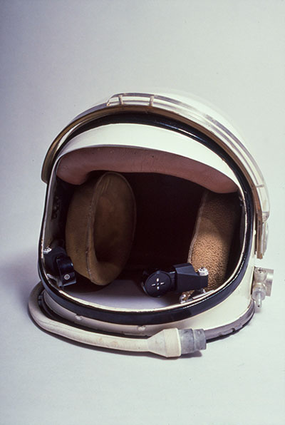

Does anyone have a good photo or information of what the inside of the early Mercury helmets looked like? Amanda Young's book, "Spacesuits," mentions a padded (leather? suede?) lining but there are no images of the inside of the helmet. The helmets that have appeared at auction seem to be very sparse inside, with just padded ear pieces and nothing else — not even a cloth lining to cover the fibreglass shell. I can even see multiple exposed screw heads for the electrical umbilical. Can't believe this would have afforded much protection. Editor's note: Threads merged. |

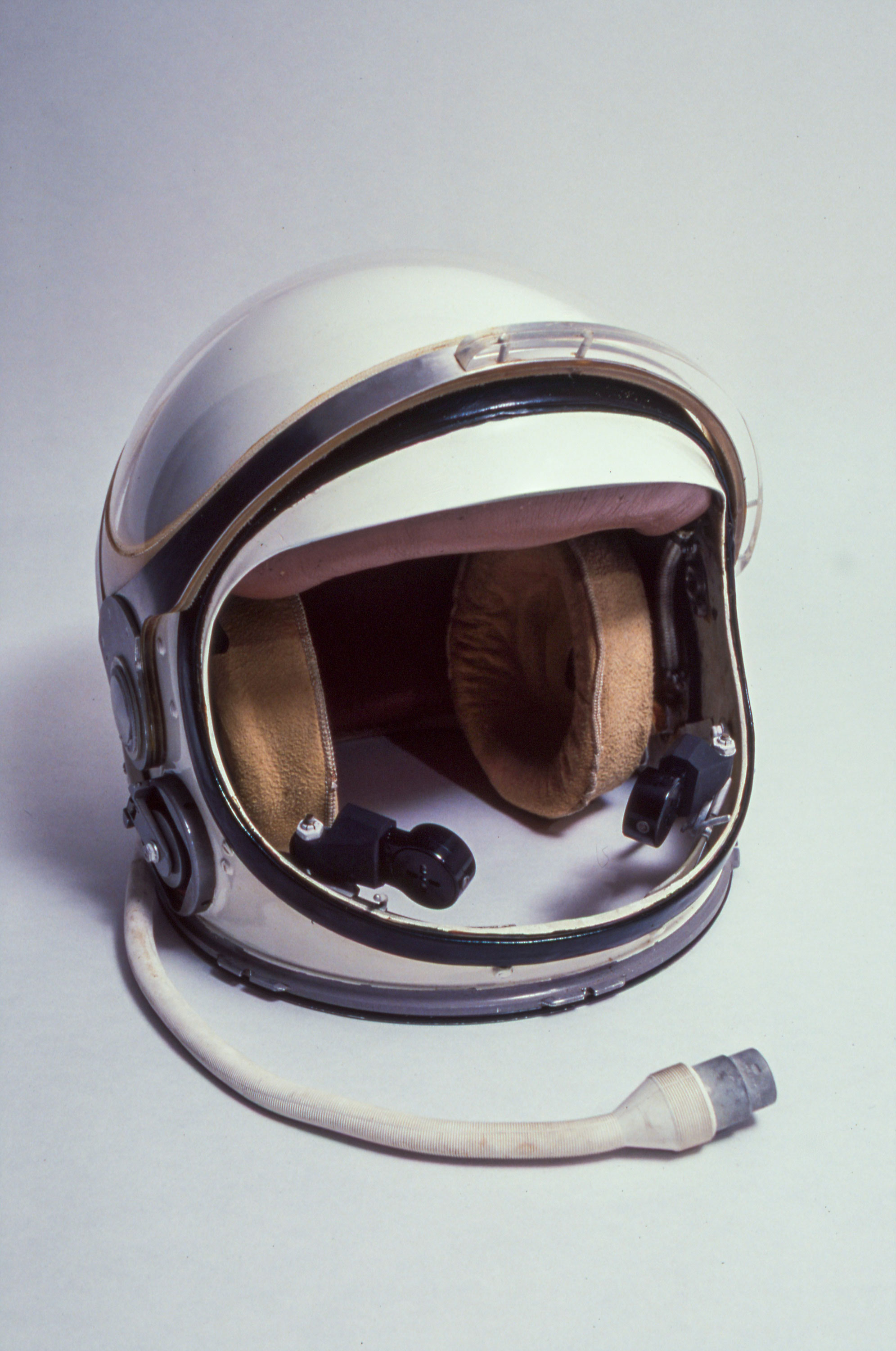

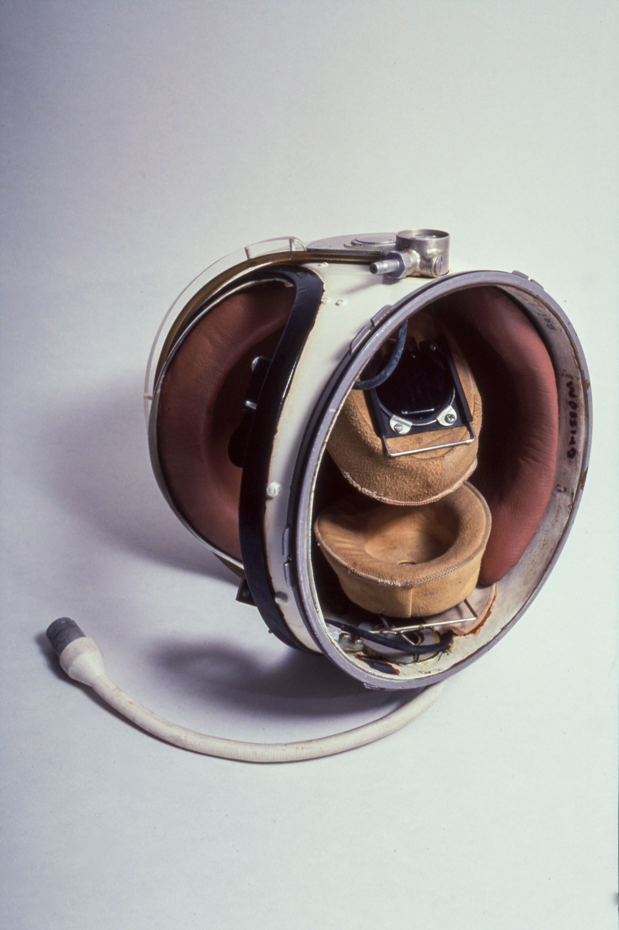

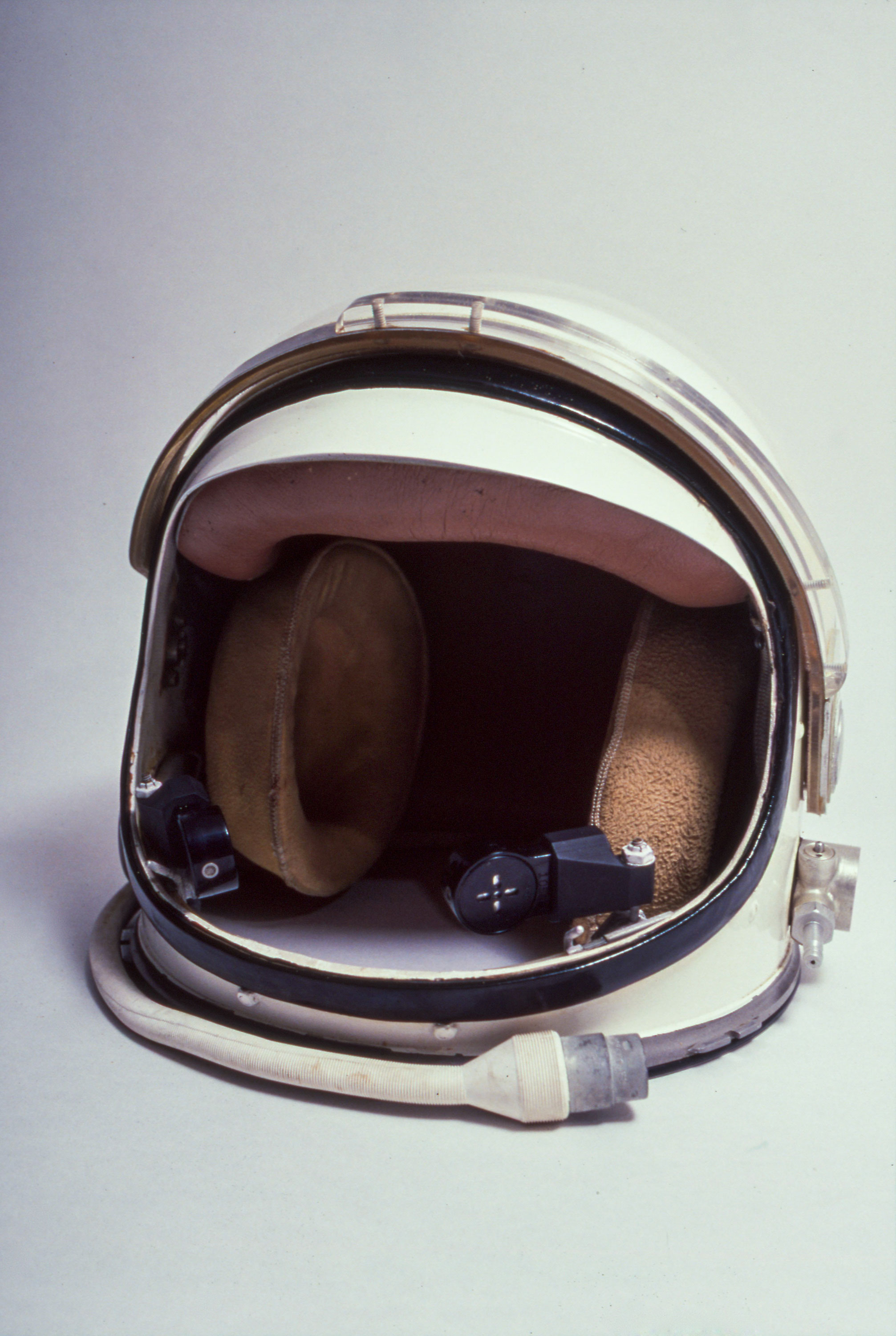

I spent some time with Gus Grissom's Mercury helmet while working on the original incarnation of the Astronaut Hall of Fame. I shot images of most of the artifacts. I'd be happy to dig through my old slides and see what I can find, but it may take a day or two. |
Joel Katzowitz Member Posts: 818 From: Marietta GA USA Registered: Dec 1999
posted 11-10-2016 01:35 PM
These images were originally shot on slide film and I scanned them for you, the quality isn't great but it's all I could do. Here are several photos of Gus Grissom's helmet. The inventory sheet referred to it as a "flight article" but there seems to be some dispute about that. In any case, I hope these images are useful to you.

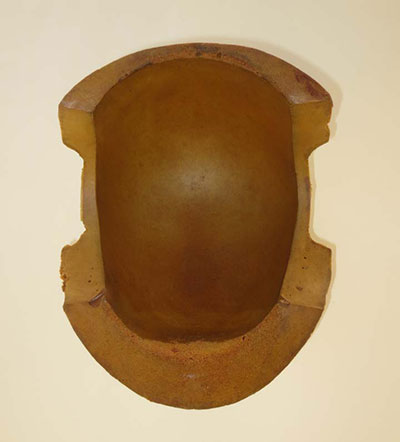

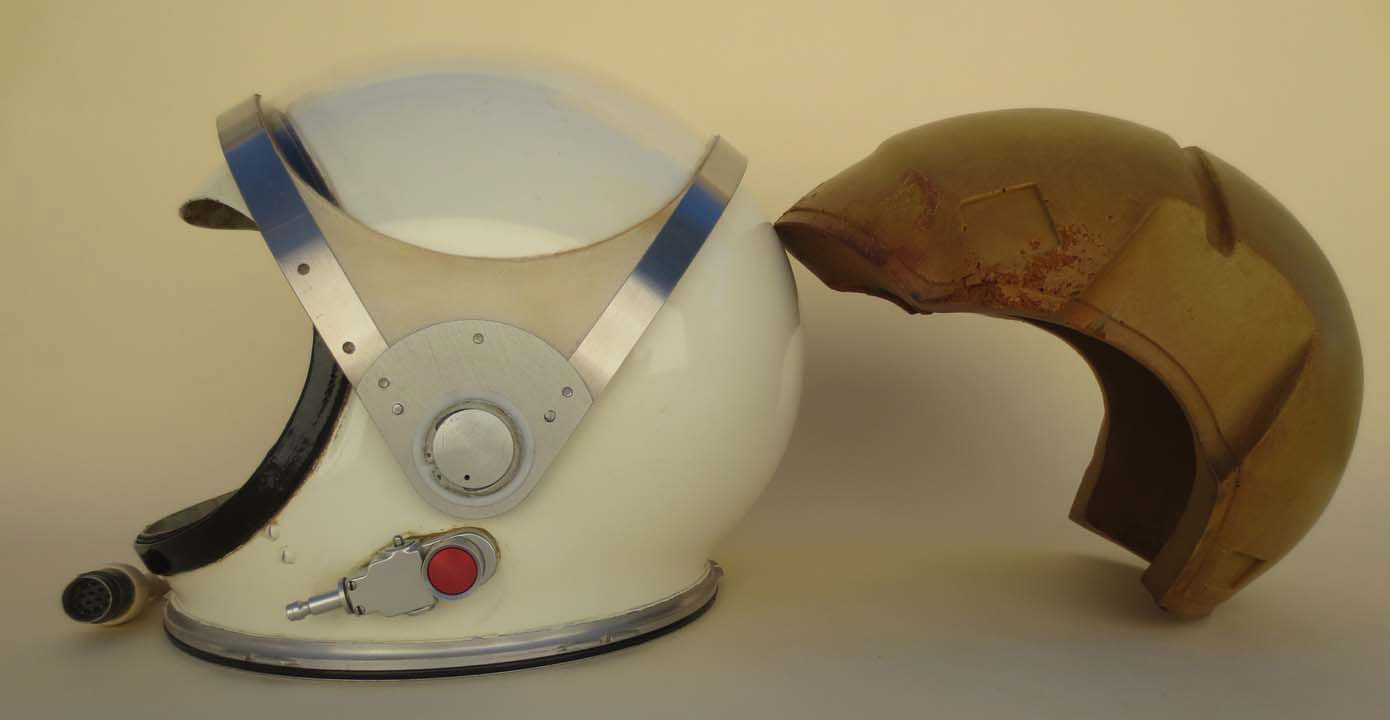

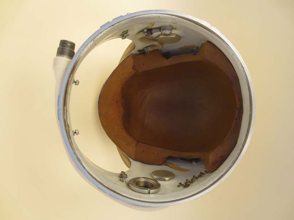

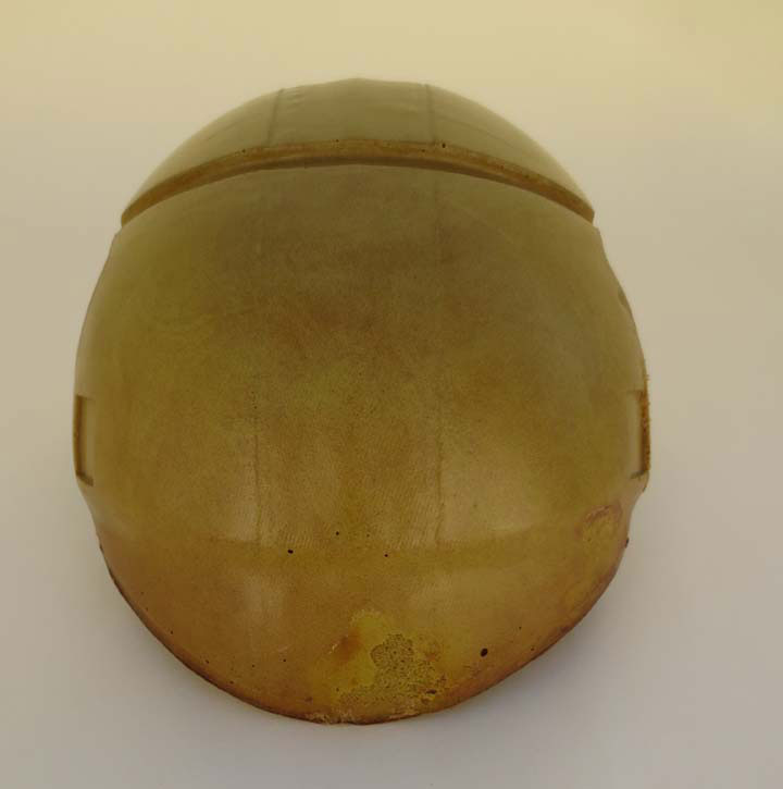

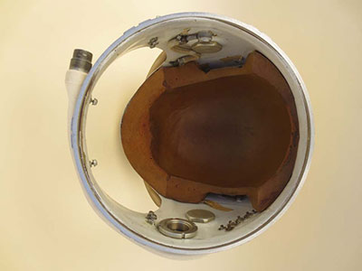

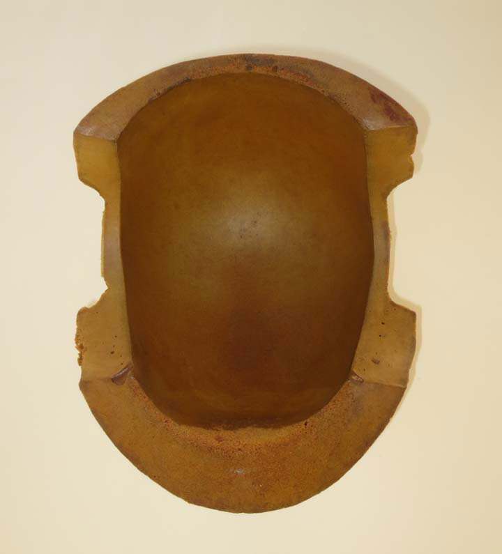

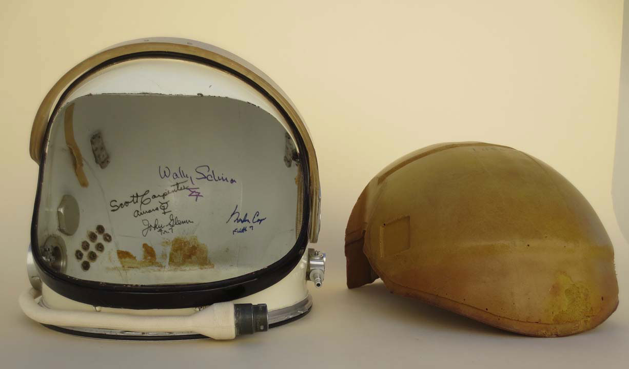

Those are great photos that Joel posted and show the liner that is in the middle of the helmet. The liner is a dense foam rubber liner that is covered on the inside with thin leather. (Regarding the Grissom helmet that Joel shows, it is indeed a non-flight training helmet, as indicated by the type of side-mounted valve.)Here are some pics that will better help understand the shape of the liner. I have the earphones out of this helmet during restoration which helps give a better view of the liner. The liner in this helmet was never finished with leather so it gives a good view of the liner construction. You can see from the pictures that although there is exposed hardware on the inside of the shell it is kept well away from the head by the conformal liner. The earphones also act as padding and fill in the open areas on the sides of the liner. The liner is molded to the inside contour of the helmet shell with cutouts for wiring and earpad suspension. The inside of the liner is molded to the wearer's head. This results in a snug fit onto the head.
