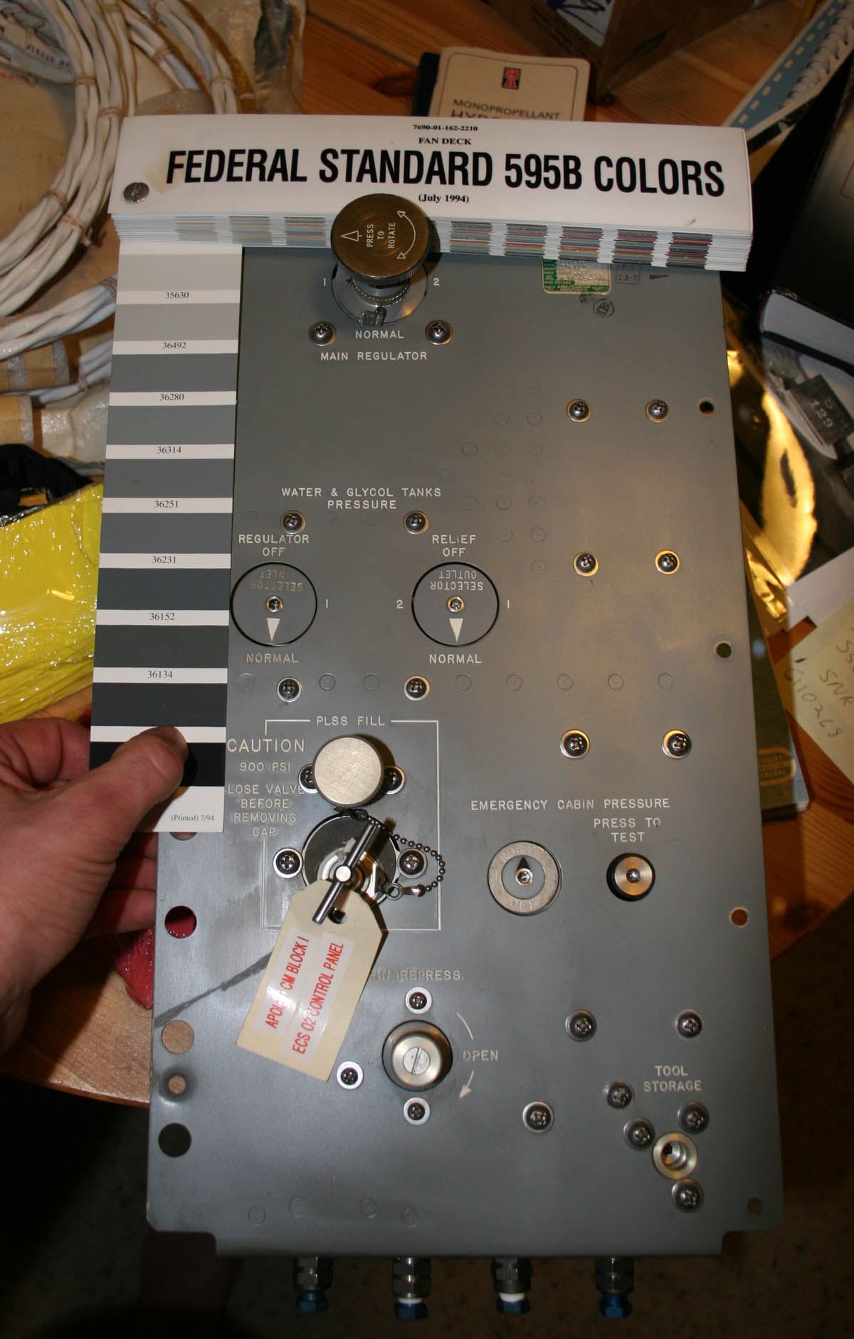

posted 09-09-2011 07:22 PM
Conversely you can send me a RAL color deck and I will shoot test shots against one of the panels |

I sent the PDF of RAL. Thank you.The colors to closer are these. Your opinion is appreciated. Thank you.  |
posted 09-10-2011 08:26 AM
Without screen color calibration dont think its possible to accurately evaluate your electronically forwarded images of the RAL pallet. Printing them out would result in the same issue (its not calibrated either) - would need an original example from the deck to shoot against the artifact if you are going for accuracy. |

posted 09-10-2011 09:27 AM
Unfortunately I do not have available an original from the deck. We will make evidence to the color of American Standard #36231 and #36251. |
ww2_1943 New Member Posts: From: Registered:
posted 09-11-2011 10:34 PM
