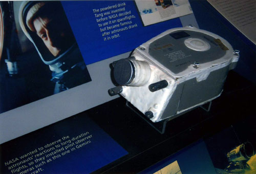

I've got a "mystery" that I'd like to put forward for all the Gemini experts in the crowd to consider. In the "extras" with the recent "Shadow of the Moon" DVD there are a couple of black-and-white film sequences that were obviously filmed inside the cabin during a Gemini flight - but the astronaut depicted is not recognizable to me or to another expert that I showed the film still to.
In the Astronaut Hall of Fame Museum near KSC, they have a camera on display that is labeled the 'Pilot Observer Camera' for Gemini long-duration flights. It is a Milliken 16 mm film camera model DBM-7 (that one NASA document referred to as a 'panel camera,' but I could not find a suitable explanation).
I am assuming that this is the camera that filmed the b&w sequences in the "Shadow of the Moon" extras.
Are any of our resident Gemini experts familiar with the Pilot Observer Camera or the films that it produced? There are some b&w films showing the Gemini 7 astronauts conducting some of their in-cabin experiments, and I assume these films were made by the Milliken DBM-7 camera.

Here are the photographs:

The Pilot Observer Camera was a feature of the Mercury control panel, mounted in the lower left section of the main panel. Its angled lens orientation is a result of the mounting location and the direction of the astronaut's head. The camera has given us the famous footage of the Mercury astronauts during their flights.
The camera was used again in the unmanned Gemini II flight, to record instrument panel readings. (See: Gemini 2 Instrumentation Panels)
To my knowledge this type of camera was never used in a manned Gemini flight. Any onboard Gemini footage would be from the Maurer 16mm camera, either handheld or window mounted.
