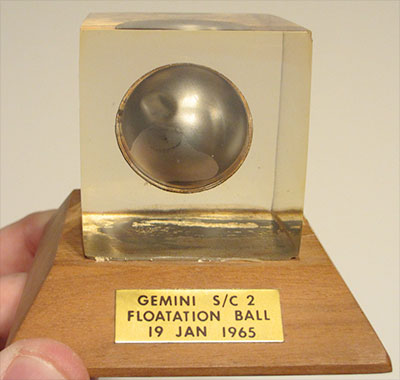

I thought it might help to add a few reference photos of the flotation balls, especially for those unfamiliar with what is being described here:
Gemini 3 Flown Floatation Ball with original McDonnell Spacecraft Parts Tag. A 1.25" diameter aluminum sphere of the type that was used in the space program to help maintain the spacecraft's buoyancy in the water. (Source: Heritage)
Flown Titanium Flotation Ball. A 1" ball in a 2" lucite cube, mounted diagonally on a 3" square wood plaque with a brass descriptive plate inscribed 'Tony Broadway / Gemini - 3 Flotation Ball / Molly Brown - Virgil Grissom'. The number '252' is marked on the ball. (Source: EarthToTheMoon.com)
A flown flotation ball for Gemini 2. Aluminum sphere measures approximately 1.25″ in diameter and is encased in an acrylic cube, which is in turn affixed to a 3.5 x 3.5 wooden base with a plaque that reads, “Gemini S/C 2, Flotation Ball, 19 Jan 1965.” (Source: eBay/RR Auction)
