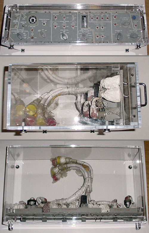

Here was the solution set implemented to protect the panel...a local fabricator out in town was able to take my chicken scratch and convert it into reality:
Would appreciate any other conservation recommendations which may be applicable to stabilizing/arresting deterioration of the piece...

Maybe you should contact the Kansas Cosmosphere for advice as they are the real experts.

I'd put small packets of silica inside the box to absorb any type of moisture that gets in there.

I hadn't thought about asking the Cosmosphere for conservatory info - will definitely do this once I am able to obtain a good point of contact... right now using desiccant buckets in the room..concern with putting desiccant within the sealed environment of the case was that it would make things to dry (any possibly render some of the panel material brittle?).
Cost to fabricate was $400 and took 5 days... and that's by the locals who observe Aloha Friday and take the rest of the afternoons off to go surfing!!

Fragile items like this panel should be stored in an inert gas and protected from damaging UV light. I would encase with 1/2" Lexan (polycarbonate) because it naturally absorbs UV, is shatterproof, easy to machine, and isn't too expensive. Provide a seal with gasketing or o-rings. Drill and tap for two NPT port fittings, then pull a vacuum on one, shut vacuum valve, backfill with nitrogen, shut valve. Oh, and Lexan scratches easily, so make sure you have a clear hardcoat on at least the viewing sides.
