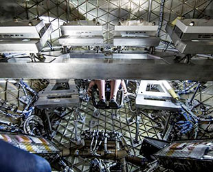

Interior view of SpaceX's Crew Dragon prior to the pad abort test showing the dummy passenger and sensors inside. (SpaceX)
No astronauts were on board the Dragon for Wednesday's test, though an instrumented dummy was strapped into a seat to collect data on the gravitational forces experienced inside the craft. SpaceX, along with Boeing, has a NASA contract to fly astronauts to the space station beginning in 2017.

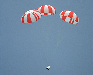

At about 20 seconds, the Dragon jettisoned its trunk and rotated so that its heat shield was again directed towards the ground. About four seconds later, two drogue chutes began deploying to stabilize the vehicle, before three main parachutes slowed the Dragon's descent.

Just under 100 seconds after leaving the pad, the Dragon returned to Earth, splashing down 0.7 miles (1,200 meters) downrange in the Atlantic Ocean. SpaceX staged boats to recover the craft for analysis.

SpaceX's Crew Dragon descends under three main parachutes to a splashdown, completing the May 6 pad abort test. (SpaceX)
