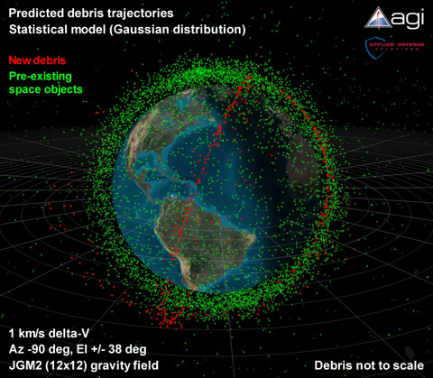

I attended a conference this past week and listened to a presentation by T.S. Kelso on the Analysis and Implications of the Iridium 33/Cosmos 2251 Collision.The 2 satellites traveling at nearly 22,000 mph less than 500 miles above the Earth struck one another at a 90-degree angle, and created quite a mess. There was another presentation from a Russian gentleman Vladimir Agapov, entitled Analysis of the Prediction Characteristics for the Collision. Some very interesting facts and revelations. Much of that debris will be orbiting the earth anywhere from the next 25 years to the next 100 years. As the meeting was going on, we were informed that a piece of a rogue rocket motor was heading towards the ISS. There is so much debris up there right now, that it is almost unimaginable. You think 'space' is a pretty big area? When you see the animation that is available by a company called AGI, they create analysis software for space situational awareness, you get to see how small 'space' really is.  Image courtesy of Analytical Graphics, Inc.There were discussions about creating some sort of a "Traffic Control Organization for Space Debris". How bad is that? Everybody and their uncles are sending rockets/payloads into space. The week was filled with tons of technological facts and information: iPods with GPS, now you can even get a program on it that will tell you what constellation in the sky you are looking at by just holding your iPod up to the heavens. Pretty soon you'll be able to launch a rocket with your iPod.  |

quote: Originally posted by Rizz: The 2 satellites traveling at nearly 22,000 mph less than 500 miles above the Earth struck one another at a 90-degree angle, and created quite a mess.
Here is a Satellite Tool Kit generated model (movie) of the collision (zip archive) and subsequent debris field (one of the applications the JSpOC utilizes to simulate such events). Note the file size is 37 megs and may take a few minutes to download depending on your connection speed - but worth the trons if you have the patience. |
