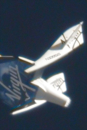

In-flight breakup of SpaceShipTwo. Click to enlarge video in new pop-up window. (NTSB)
"A forward-facing cockpit camera and flight data showed that the copilot unlocked the feather just after SS2 passed through a speed of 0.8 Mach," investigators described in a summary of the findings. "Afterward, the aerodynamic and inertial loads imposed on the feather flap assembly were sufficient to overcome [its] actuators."

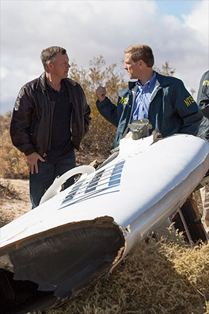

National Transportation Safety Board (NTSB) team members view debris from SpaceShipTwo's tail booms where the parts fell back to Earth in California's Mojave desert in October 2014. (NTSB)
