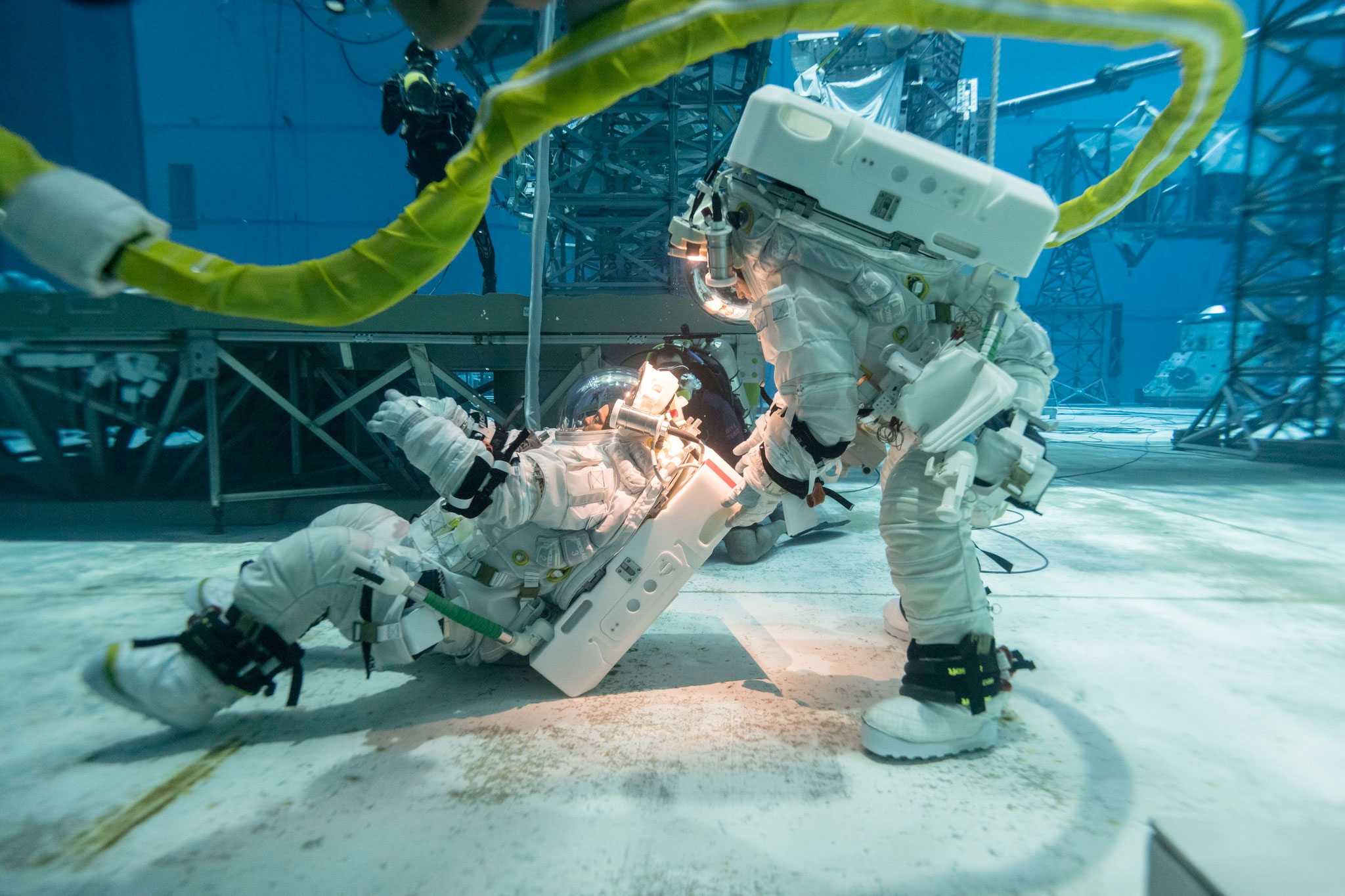

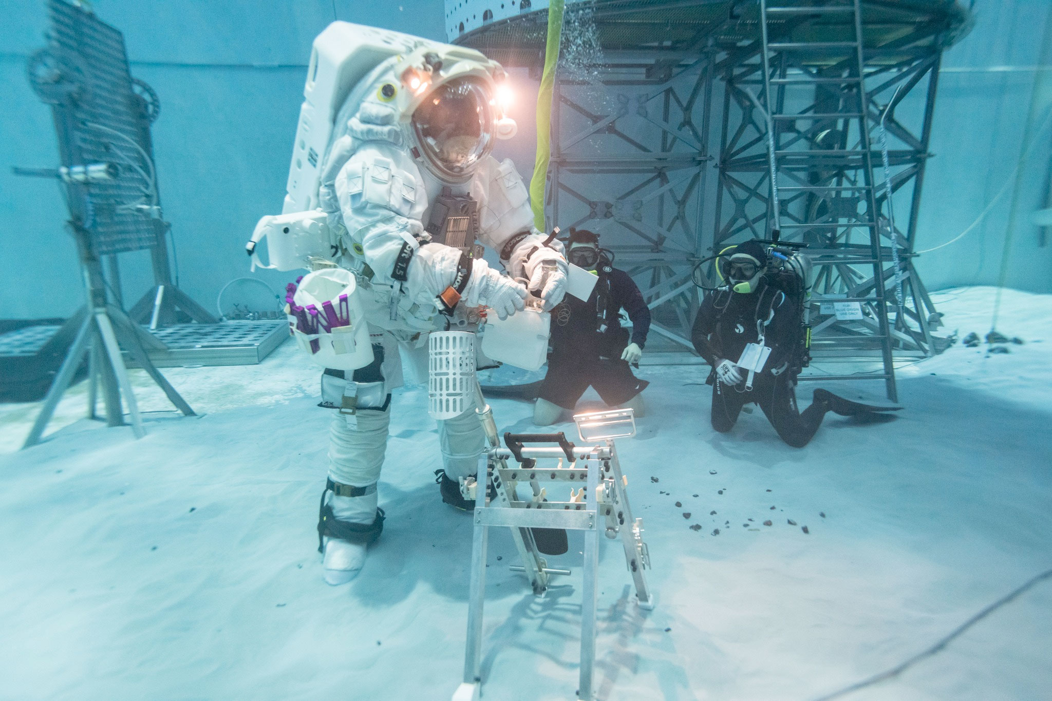

posted 04-29-2024 07:05 PM     Click Here to See the Profile for Robert Pearlman   Click Here to Email Robert Pearlman     Edit/Delete Message   Reply w/Quote
From Axiom Space (via X):
The AxEMU entered the water for the first time this week at NASA's Neutral Buoyancy Laboratory (NBL). Testing was conducted with an unoccupied spacesuit, adding weights to accurately simulate the lunar environment, where gravitational forces are 1/6th of Earth's.
With the successful conclusion of this trial run, the next NBL suit run will have our very own astronaut inside ... stay tuned!

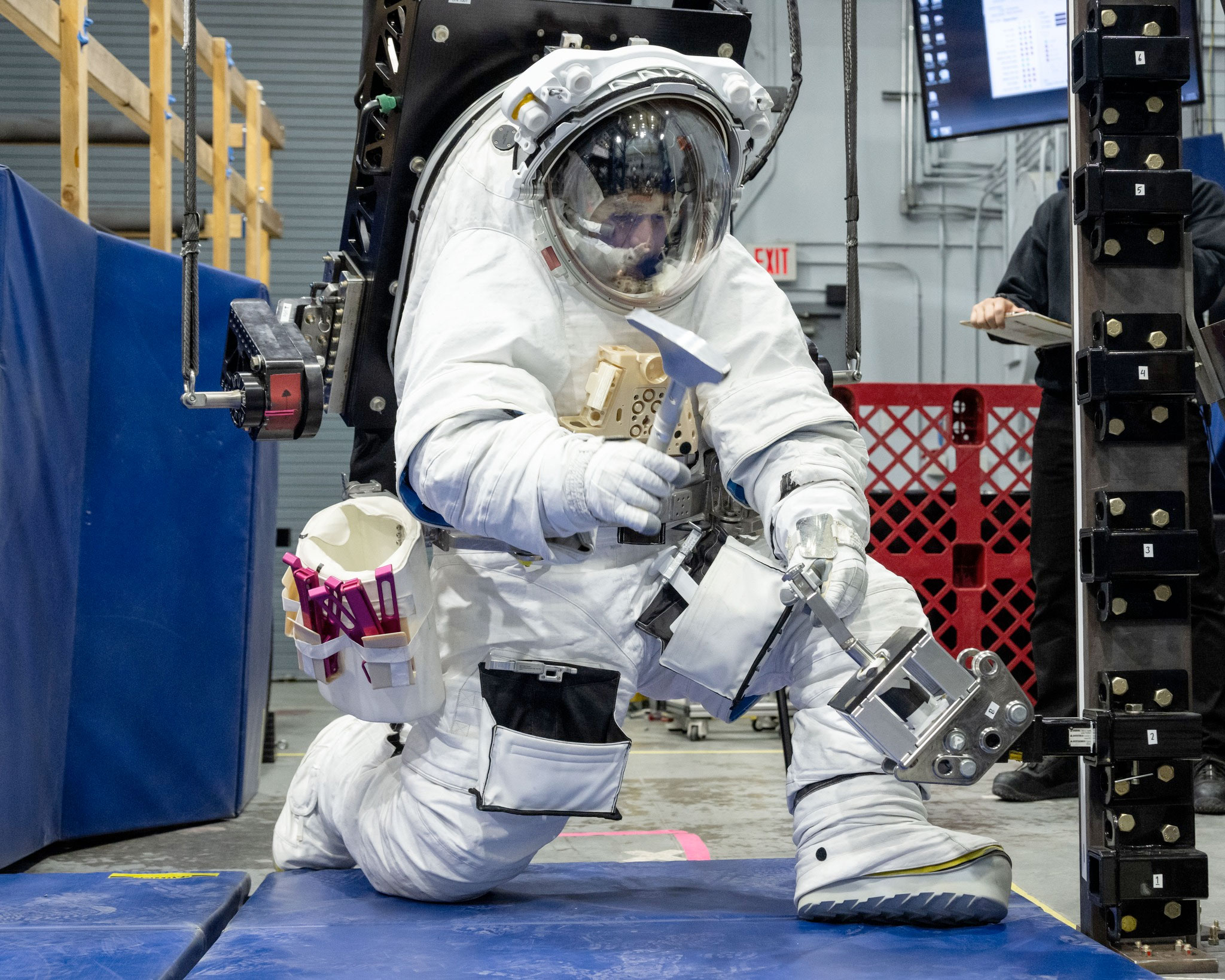

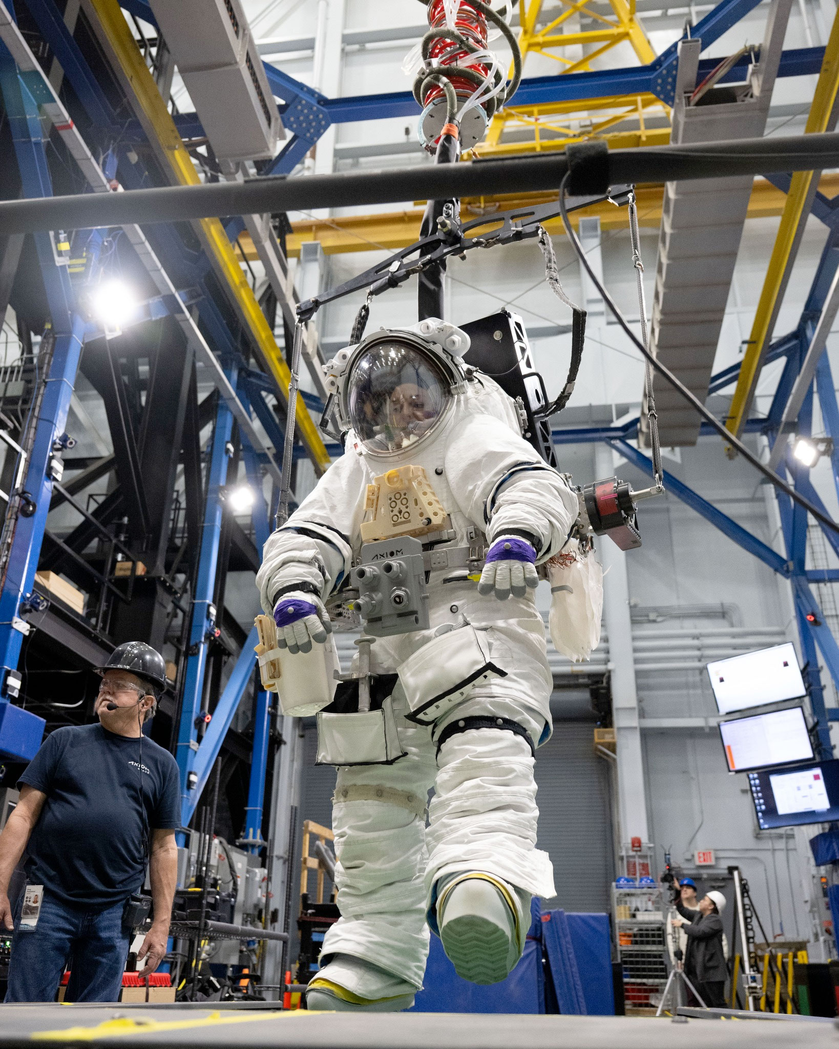

posted 02-12-2026 03:12 PM     Click Here to See the Profile for Robert Pearlman   Click Here to Email Robert Pearlman     Edit/Delete Message   Reply w/Quote
Originally posted by SkyMan1958:
Just wondering, will Axiom's financial situation affect its ability to produce the spacesuits...
Axiom today announced (Feb. 12) it has raised $350-million in financing to, in part, ready the AxEMU.
NASA also released photos of the suit undergoing pressure load testing:
