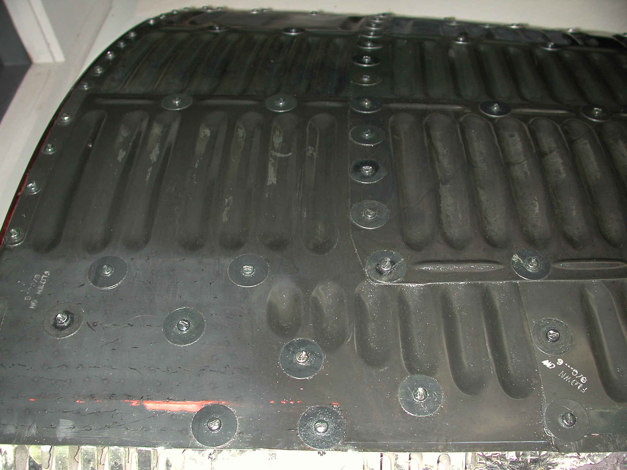

The exterior shingles were in very good condition. All panels appeared to be original and intact. No restoration will be required to these areas.

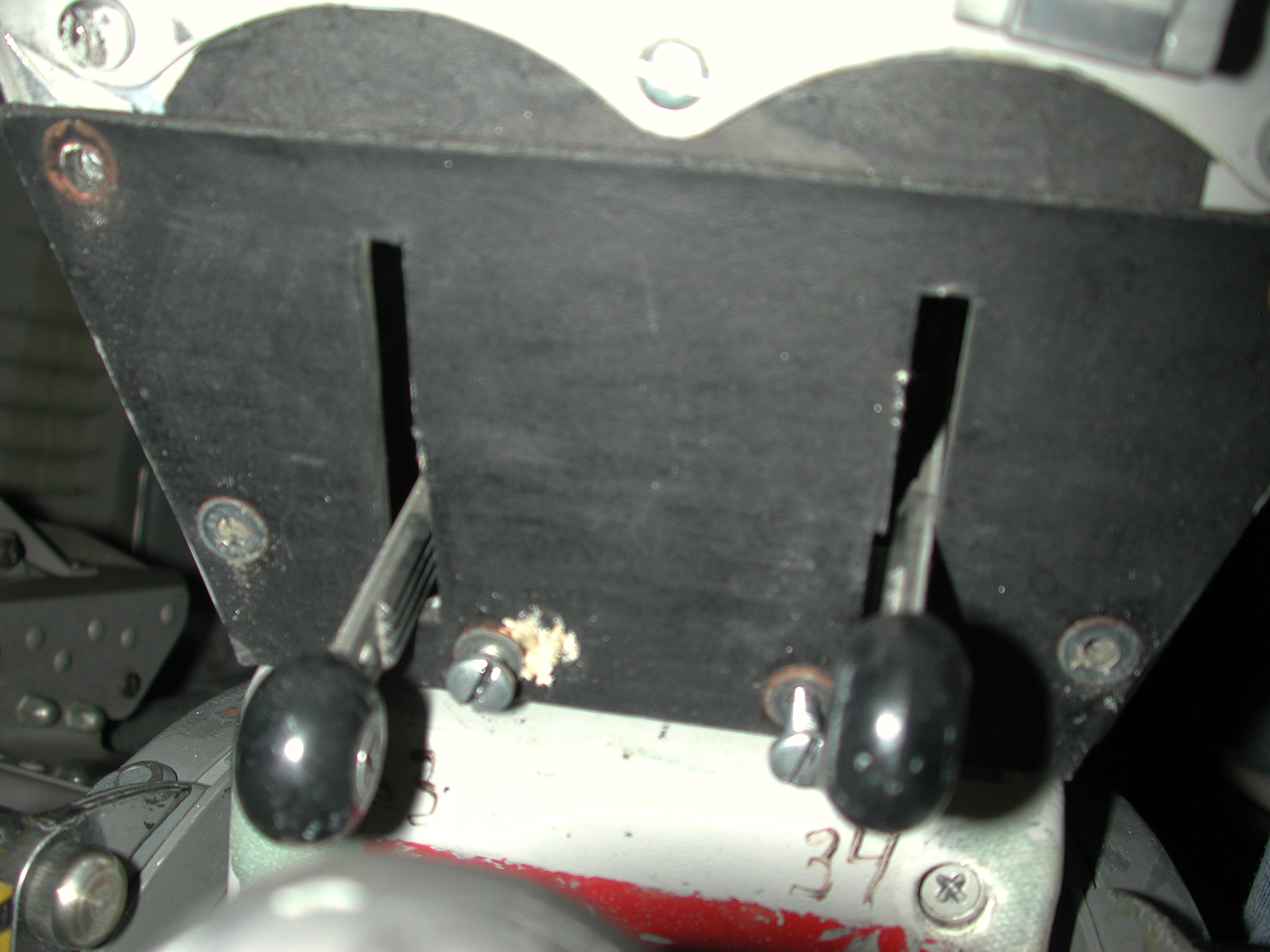

  • Cabin recirculation levers

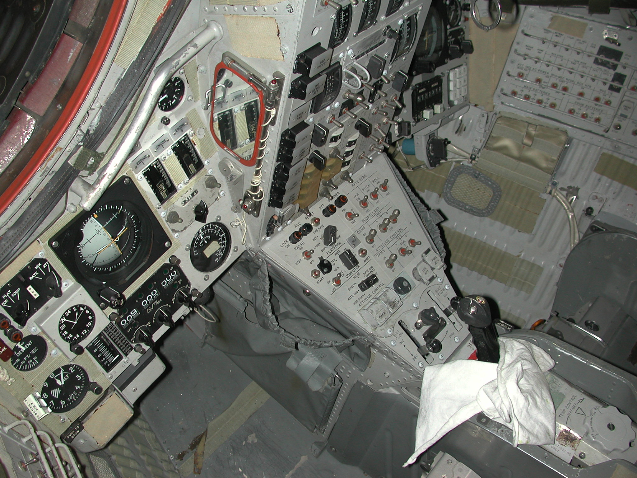

  • Majority of interior hardware now reinstalled.

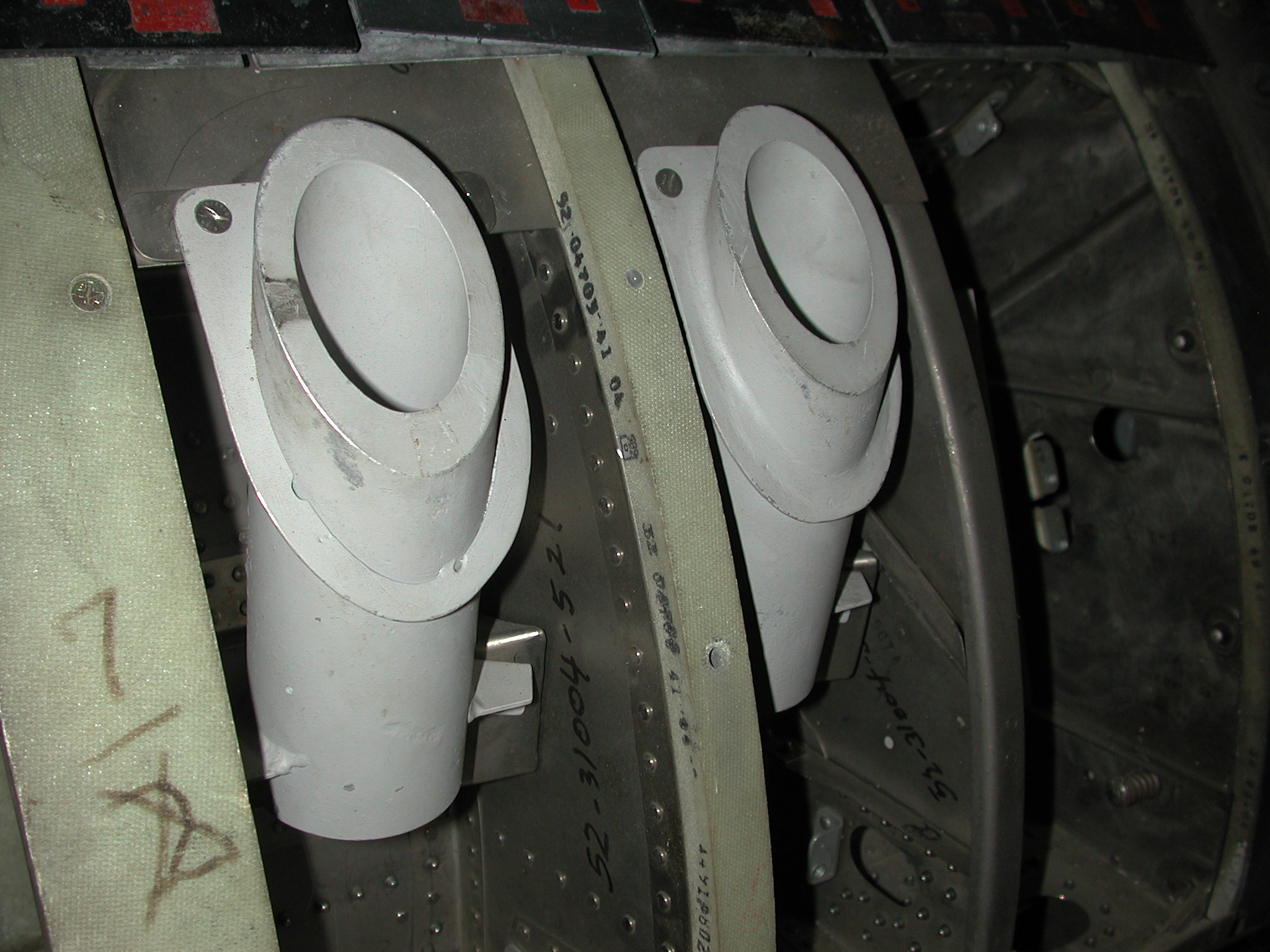

  • Removed command side RCS panel. Removed 2 mockup RCS engine. Installed two flown RCS engines in their place.

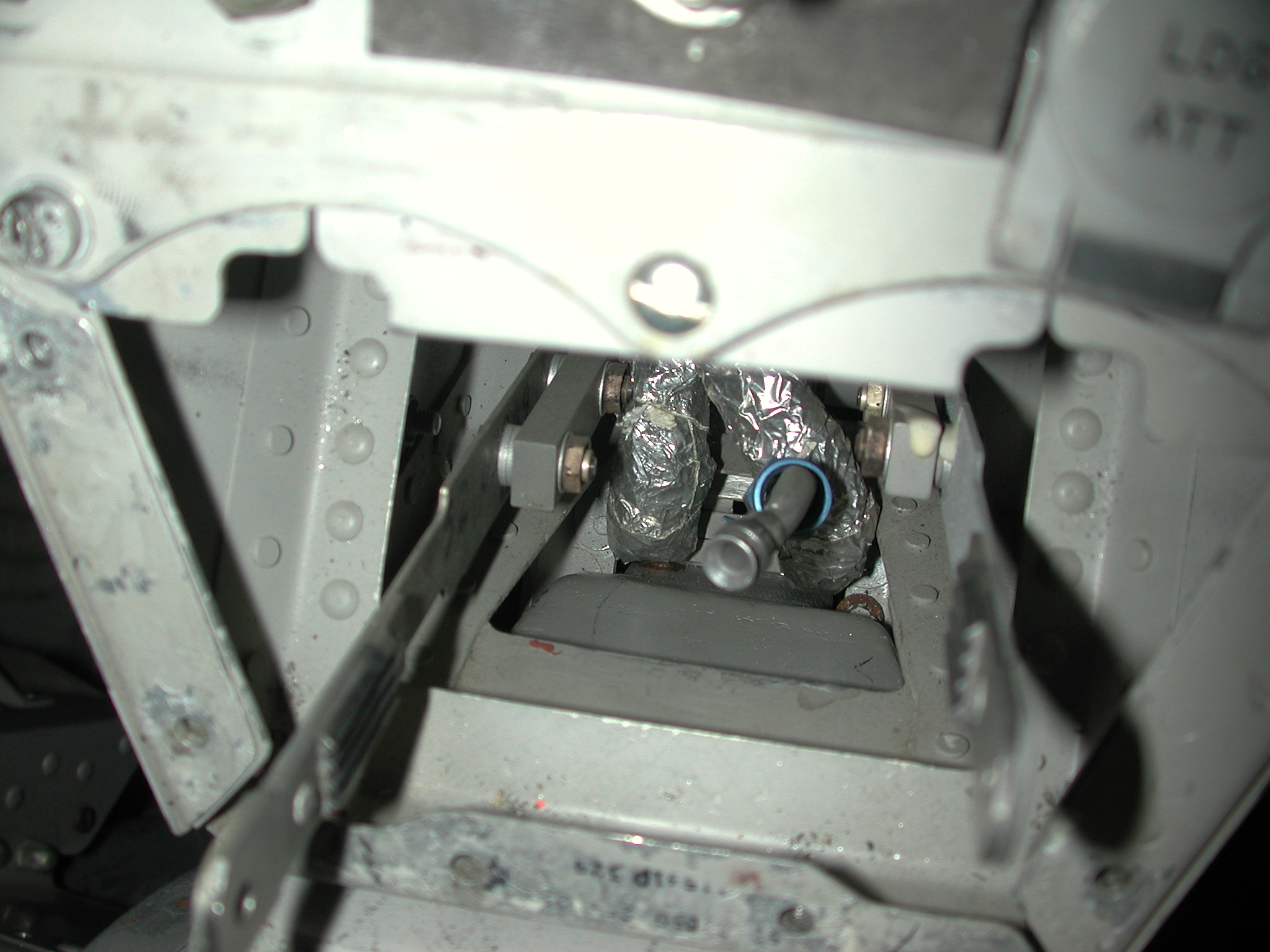

  • Removed pilot side forward RCS panel. Interior forward RCS section looks good. No signs of active corrosion. RCS engines are mockups. I have one flown RCS engine to reinstall.
  • All interior forward RCS insulation blankets have been removed prior to this restoration. It has been decided not to reinstall the insulation due to its condition and potential to attract moisture.

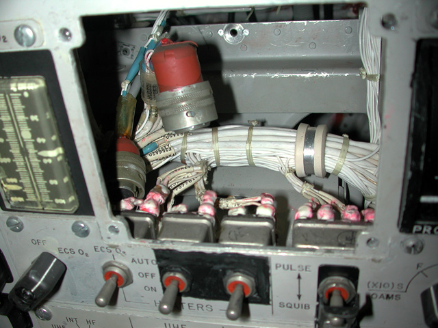

  • Continued to reinstall flown hardware. Reinstalled air flow pane; ENCR Timer; circuits (drogue parachute circuits/ECS circuits); switch covers.

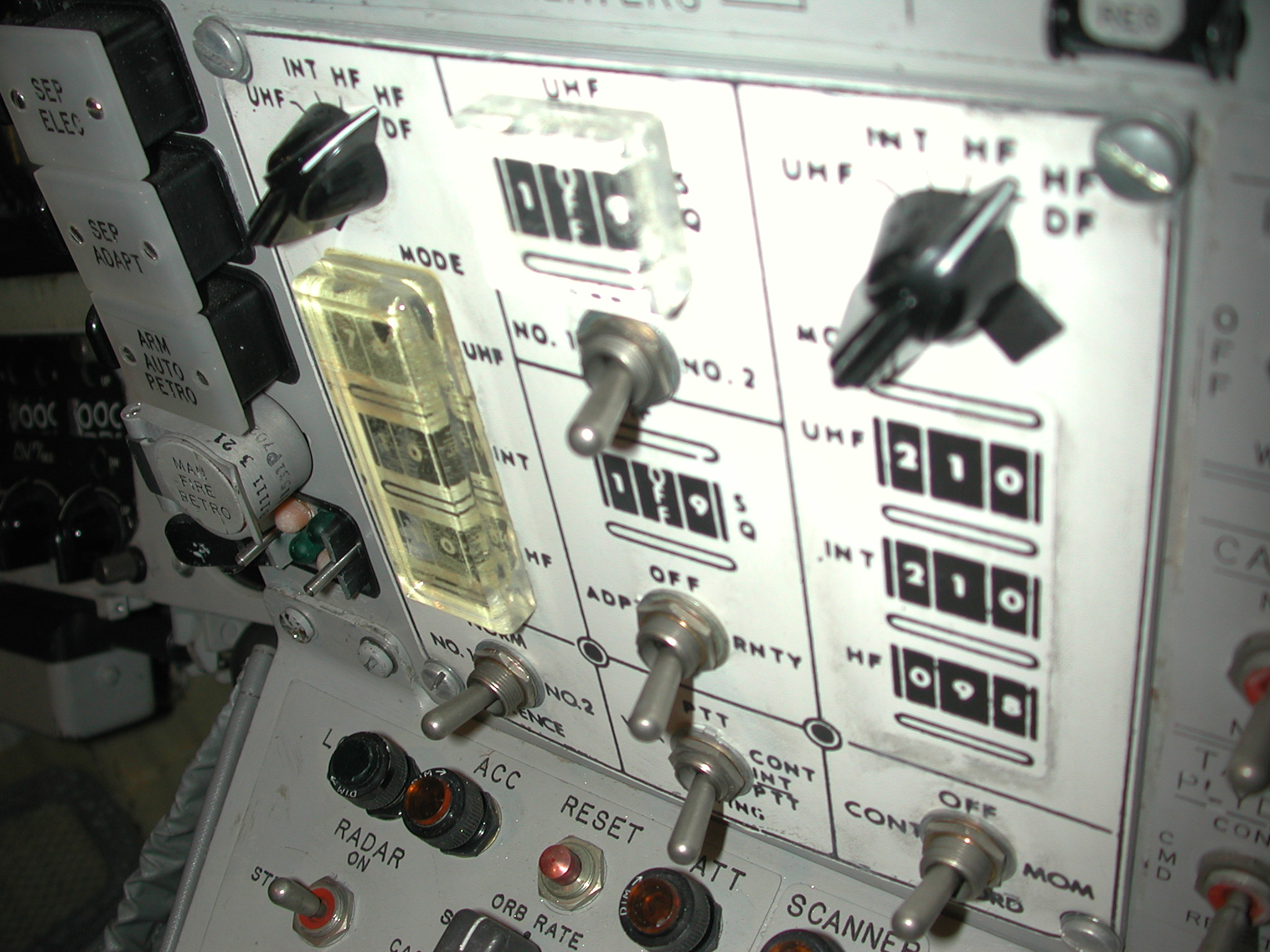

  • Inspected hatch, again no reappearance of corrosion. Will clean the hatch one more time.
  • Interior hatch window needs to be reinstalled.
  • Removed final mockup hardware from interior.

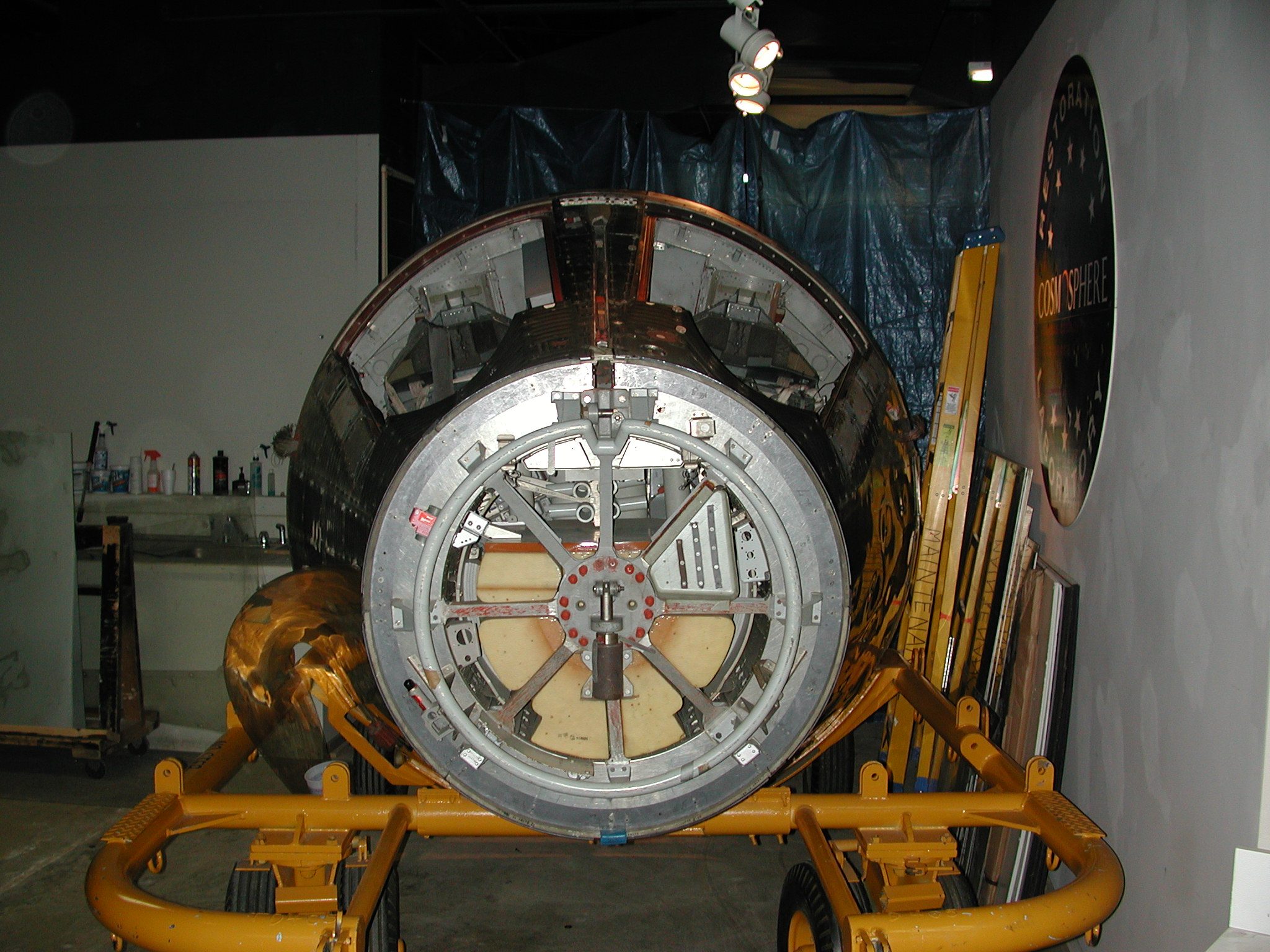

  • Removed three shingles from pilot side of spacecraft to inspect the super structure of the craft. Interior super structure/skeleton in very good condition, no signs of corrosion.
  • All interior insulation had been removed prior to this restoration.

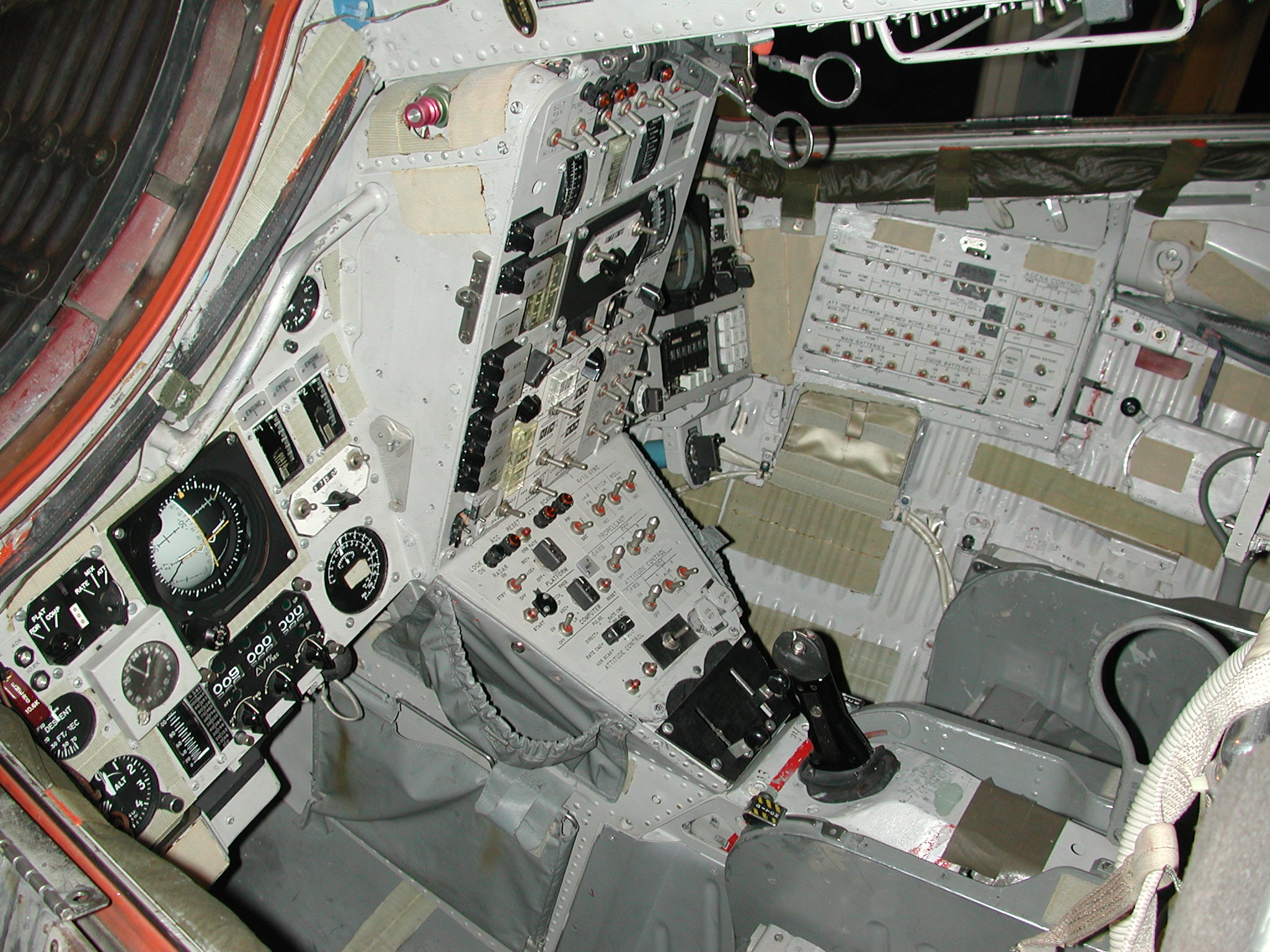

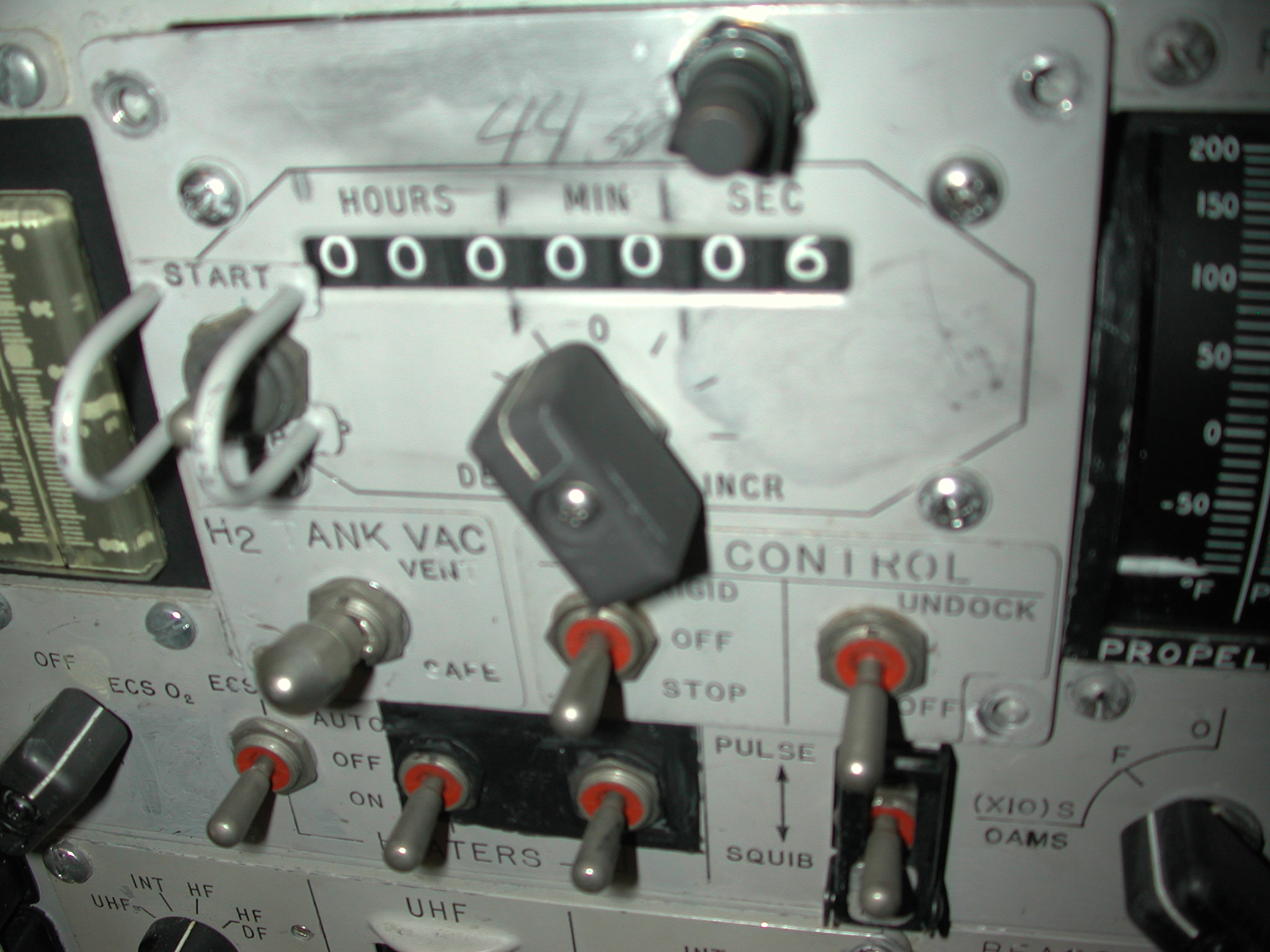

  • Began to reinstall flown hardware back into spacecraft. Reinstalled the pedestal panel; cabin temperature control knob; several overhead switches and circuits; command side drogue and parachute switches; pilot side encoder controller; waste management hardware; interior cabin mirrors.
  • Will continue to install hardware, gauges, switches and circuits, as well as interior insulation blankets.
  • Once all hardware is reinstalled, I will clean the interior of the spacecraft. After the interior is cleaned, the pilot side hatch will be reinstalled.
  • The final step in the restoration will be the total cleaning of the exterior of the spacecraft.

  • Continued to remove mockup hardware.
  • Finished cleaning corrosion from pilot hatch. Noticeable difference from pre-cleaning of hatch and post-cleaning.
  • Will let the hatch set to see if corrosion reappears.

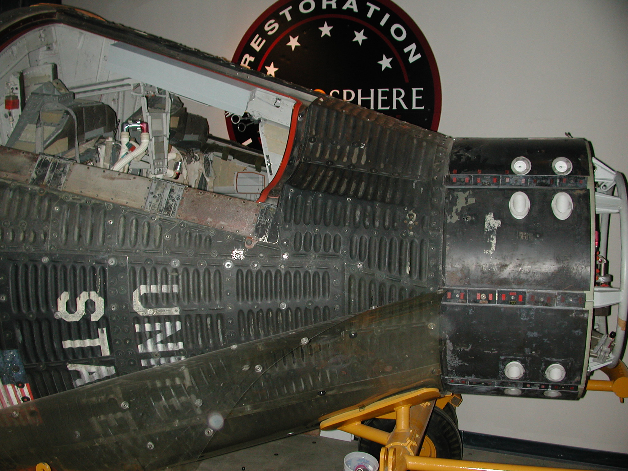

  • Finished removing the plexi covering. Smell of off gassing is no longer present.
  • Began to remove corrosion from Pilot hatch. Cleaning with hatch with mineral spirits. Dirt and corrosion coming off nicely.
  • Began to remove interior mockup hardware.

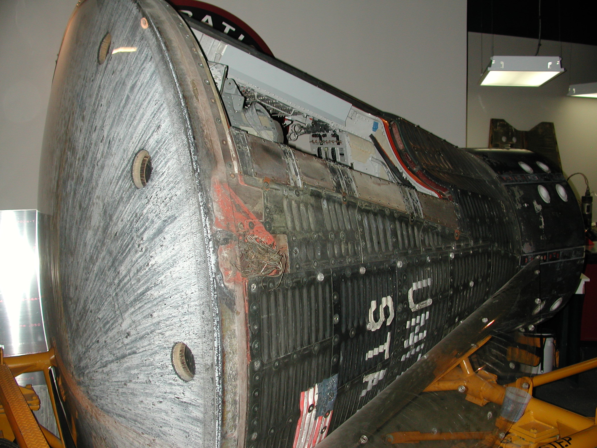

  • Conducted an initial analysis of spacecraft. Overall in good condition. Pilot side hatch has more corrosion than anticipated.

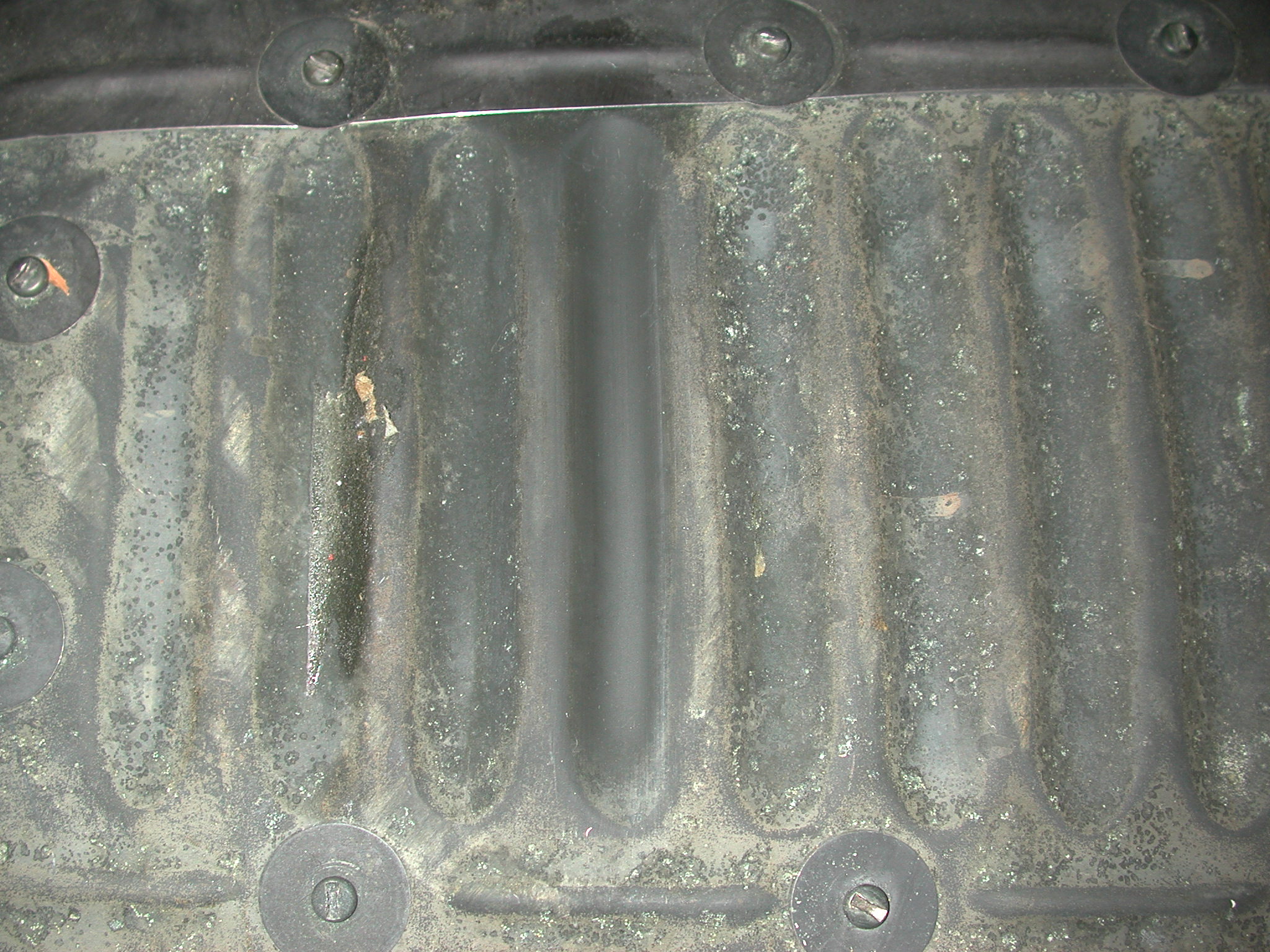

  • Overall, the exterior of the capsule is very dirty. There is some corrosion. The majority of this is probably a result of the protective plexi cover (dust build-up in groves of shingles is great). The exterior of the spacecraft will need a great deal of cleaning.
  • The interior is dirty and full of dust. More mockup hardware than first thought.
