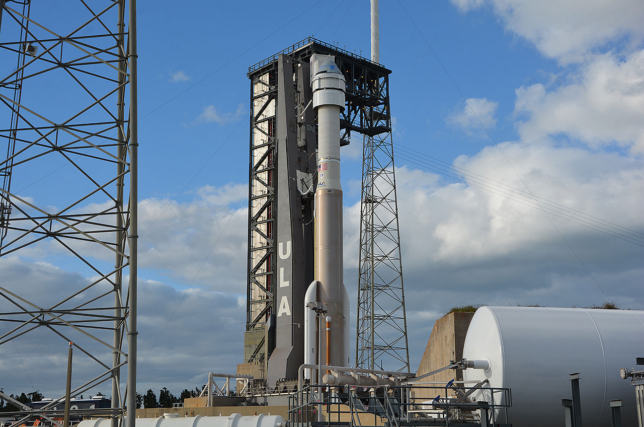

A United Launch Alliance (ULA) Atlas V rocket with Boeing’s CST-100 Starliner spacecraft on board is seen ahead of the Orbital Flight Test, Thursday, Dec. 19, 2019, on Space Launch Complex 41 at Cape Canaveral Air Force Station in Florida. (collectSPACE)
