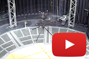

The prototype's May 31, 2016 flight took place in JPL's Space Simulator, a 25-foot-wide (7.62-meter) vacuum chamber. The Martian atmosphere was simulated by first evacuating the air from the chamber and then backfilling it with a small amount of carbon dioxide.
The prototype was built to be the same size as the rotorcraft flown to Mars, but differed in construction in some significant ways.
"The system was still a skeleton," Teddy Tzanetos, Ingenuity's project manager, said in a 2020 presentation delivered as part of a workshop on planetary exploration robots. "It had the [infrared] tracking balls to track the motion of the helicopter in the chamber, but there was no power system on board, no computer on board, it was really just an actuator but this let us baby step our way forward."

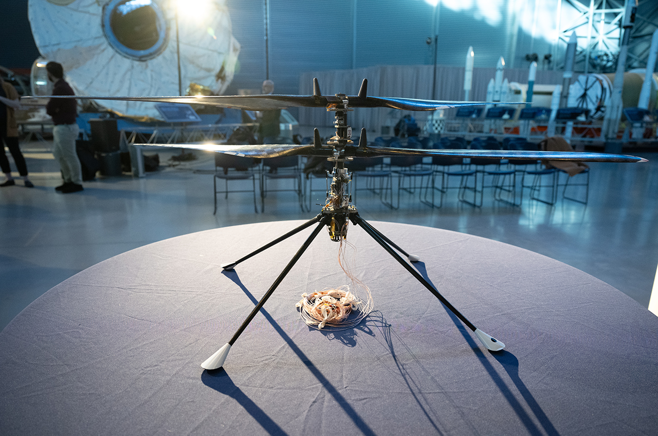

NASA's aerial prototype for its Ingenuity Mars Helicopter has been donated to the Smithsonian's National Air and Space Museum as an artifact of the rotorcraft now on Mars. (Smithsonian/Mark Avino)
Video (click to view): On May 32, 2016, the aerial prototype for the Ingenuity Mars Helicopter took flight for the first time, demonstrating stable control in a simulated Mars environment. (NASA/JPL)

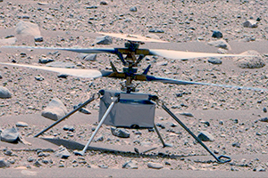

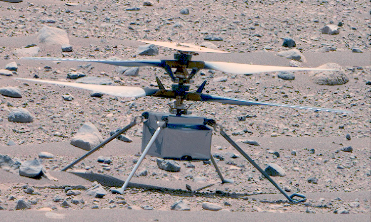

NASA's Ingenuity Mars Helicopter as seen by the Perseverance rover on April 16, 2023, three days shy of two years after the rotorcraft made history by achieving flight on the red planet. (NASA)

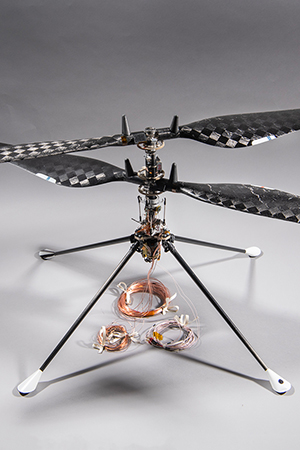

The aerial prototype of the Ingenuity Mars Helicopter is seen at the National Air and Space Museum's Steve F. Udvar-Hazy Center, Friday, Dec. 15, 2023, in Chantilly, Virginia. (NASA/Joel Kowsky)
