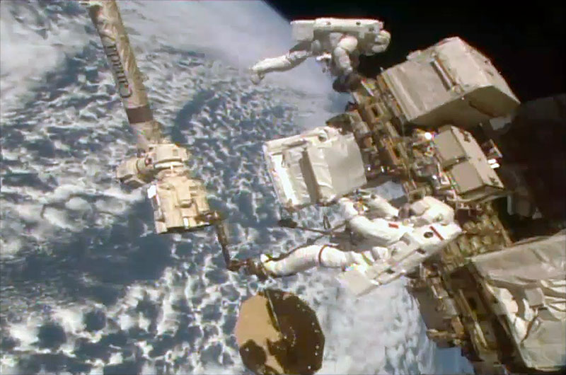

Astronauts Luca Parmitano (in foreground) and Drew Morgan work outside the International Space Station on Dec. 2, 2019. Parmitano, positioned at the end of the station's Canadarm2 robotic arm, is holding the new pump module for the Alpha Magnetic Spectrometer (AMS) cosmic ray detector. (NASA TV)

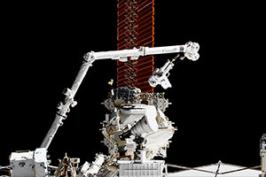

Astronaut Luca Parmitano, restrained at the end of the International Space Station's Canadarm2 robotic arm, moves the new coolant pump module for the Alpha Magnetic Spectrometer (AMS) during a spacewalk to repair the cosmic ray detector on Dec. 2. (NASA TV)
