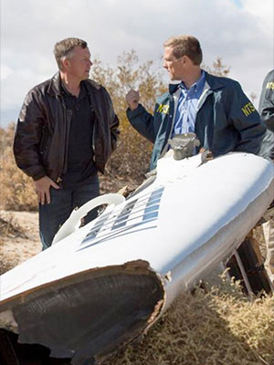

National Transportation Safety Board team members view debris from SpaceShipTwo's tail booms, or feathers, where the parts fell in the Mojave desert in California. (NTSB)
