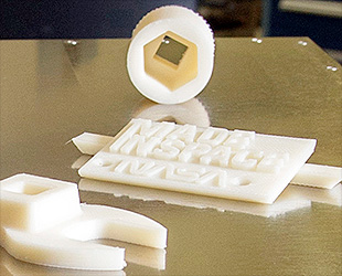

Sample printed parts from the Made In Space 3D printer, like the type that could be created on the space station. (Made In Space)

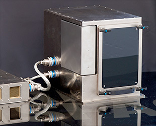

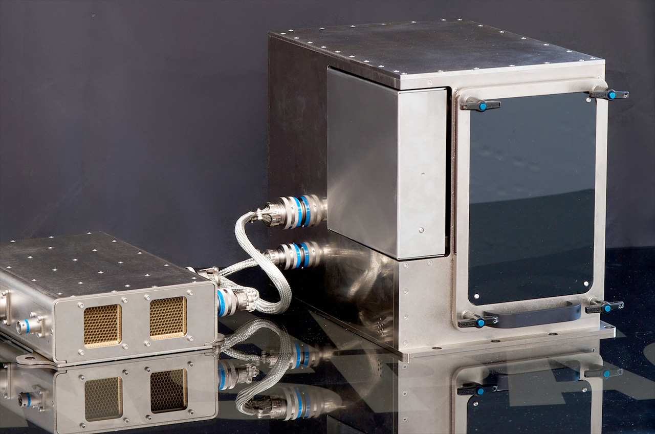

A "machine shop for space," the Made In Space 3D printer will mark the first time that a multi-purpose manufacturing device will be utilized off-world to create parts and tools. (Made In Space)

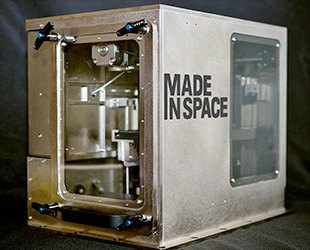

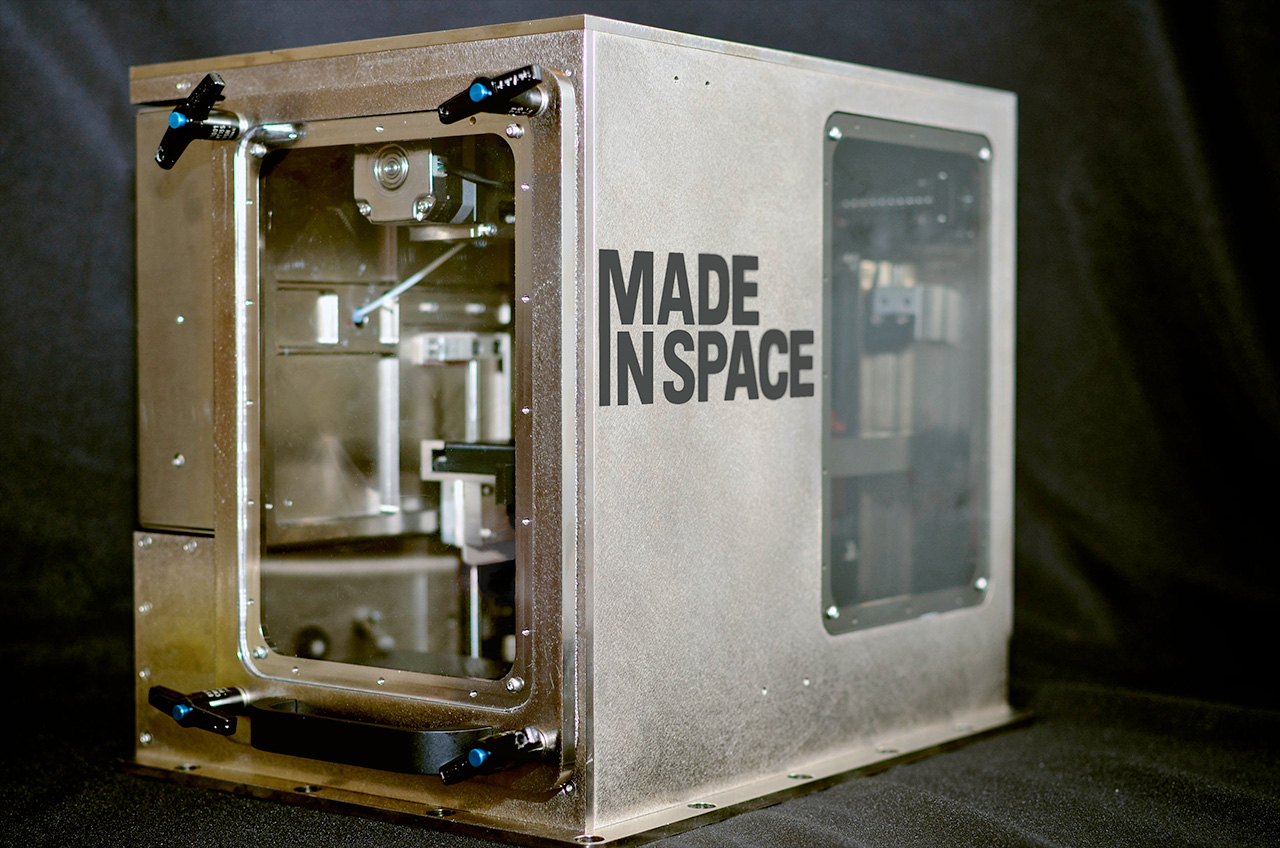

The printer, which is about the size of a small microwave, can create items that measure up to 2 by 4 by 2 inches (5 by 10 by 5 centimeters). The printed parts are made out of ABS plastic, the same material used to make LEGO toy bricks.

"The printer will be producing a bunch of coupons, some functional in nature and some test in nature," Snyder told collectSPACE. "We are going to be getting a good idea of what characteristics this plastic has in microgravity and then compare that to ground samples. So, a good portion of the things we are producing will be to meet that goal of that mission.

Made In Space's 3D printer will be the first manufacturing device ever used off Earth. It will be installed in the International Space Station to print a series of test items. (Made In Space)
"The first set of parts are predefined," Snyder said about the parts core to the mission. "And then the other things are going to be functional, such as small tools, containers, things of that nature, just to show that you could actually use this stuff for a purpose up there."

The Made In Space zero-gravity 3D printer is seen with the space station microgravity glovebox that will contain it. (Made In Space)
