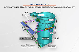

Exiting the U.S. Quest airlock, Hoshide and Pesquet made their way to the port (or left-hand) side of the space station's backbone truss to a position referred to as P4. There, they worked together to build a bracket structure, called a modification kit, and then mounted it to the mast canister at the base of one of the existing P4 solar arrays.

The kit prepared the site for the future installation and deployment of the third of six new International Space Station Roll-Out Solar Arrays (iROSAs). The array will upgrade one of the station's eight power channels, known as 4A, which provides partial power to the U.S. Destiny lab, the Harmony node and European Columbus module.

NASA infographic detailing the components of the International Space Station Roll-Out Solar Array augmentation modification kit as installed by Expedition 65 crew members Aki Hoshide and Thomas Pesquet during a Sept. 12, 2021 spacewalk. (NASA TV)
