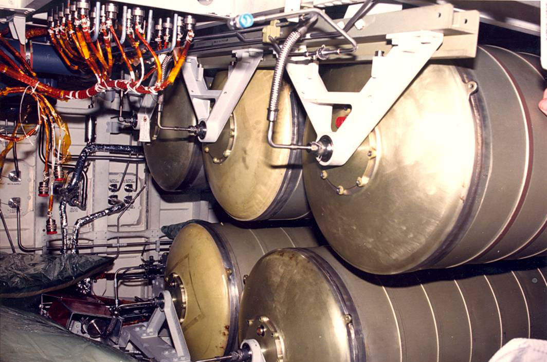

Each of Endeavour's potable water tanks measures 3 feet long by 1.3 feet wide (0.9 by 0.4 m) and weighs 40 pounds empty (18 kg). Together with a single waste water tank of similar dimensions, they are located underneath the crew cabin's lower living space called the mid-deck.
Workers will enter the orbiter, which is exhibited inside the science center's Samuel Oschin Display Pavilion, through the same hatch that was used by the astronauts to enter and exit the space shuttle before launch and after landing. The hatch is normally kept closed as the center's visitors are not allowed to tour inside the vehicle.
Using a lift to reach the hatch, the NASA workers will gain access the tanks through the mid-deck's floor. Under the seats where mission specialists sat for launch and landing is a locker that held the lithium hydroxide (LiOH) canisters used to clean the orbiter's air of carbon dioxide. Unbolting and lifting out that container offers a pathway to drop down below the deck.
From there, it is the relatively simple task of detaching the plumbing and electrical connectors that lead to each tank and unbolting the four tanks themselves from the rails that held them in place.

Photo showing the potable and waste water storage tanks on the lower deck of the space shuttle. The California Science Center is letting NASA remove the tanks from inside the shuttle Endeavour for use aboard the International Space Station. (National Archives)
