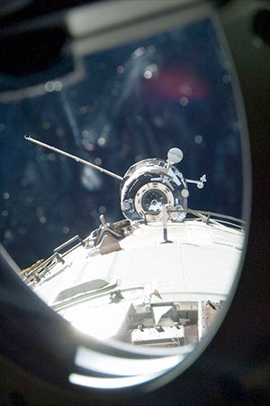

Last month, Russian cosmonauts — who had been using the TVIS since it was replaced in the U.S. segment of the space station by the COLBERT (or "T2") — uninstalled the treadmill and packed it inside the Progress M-19M (51P) unmanned resupply craft to discard with other no-longer-needed hardware and trash. The cosmonauts now use the БД-2 (BD-2) treadmill, Russia's first new space exercise machine since the space station Mir.
Progress M-19M undocked from the station Tuesday at 9:58 a.m. EDT (1358 GMT). The spacecraft is scheduled to perform a deorbit burn on June 19, which will begin its destructive descent back into the Earth's atmosphere.

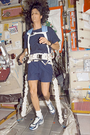

"On Earth, of course, gravity is holding you down. You don't have to wear any type of equipment that will hold you down," Williams said. "On TVIS, you had a harness that went over your shoulders and around your waist and then had two connecting points on either side of your hips that connected it to the structure, the frame of the treadmill. That way, every time you pushed up, it pulled you back down."
"The amount it was pulling you back down dictated how much you 'weighed.' It put a force back into the treadmill and so if the force was higher, you weighed more," she said. "You can think of it simply as a bungee that had to be stretched further and further and the more that it was stretched, the bigger the force."

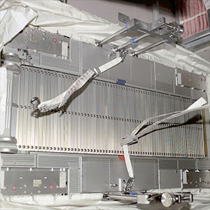

"TVIS sat on a gyro, so when it started, it was a little bit wobbly," Williams recalled. "The gyro spun up, it had to get up to a certain [rotation per minute] to be stabilized, and then TVIS could move in all six degrees of freedom."

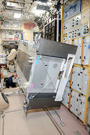

Other differences between the TVIS and its successors included its user interface — TVIS had a dedicated control panel while T2 uses a laptop for control — and its running surface. TVIS was much more narrow than the newer T2 treadmill, or those back on Earth.
"TVIS was skinnier, so you always had that feeling you're having to watch where you are stepping so you were not inadvertently stepping [off]," Williams said.

The International Space Station's first treadmill, referred to as the Treadmill Vibration Isolation System (TVIS) is seen in the orbiting outpost being prepared for its disposal. (NASA)
The Progress M-19M (51P) Russian cargo craft is seen through a window arriving at the International Space Station in April 2013. It departed on June 11 packed with trash, including the station's first treadmill, destined to be destroyed during re-entry. (NASA)
NASA astronaut Suni Williams, equipped with a bungee harness, exercises on the TVIS treadmill in December 2006. (NASA)
The TVIS, with its narrow running track, as it looked installed in the service module of the International Space Station. (NASA)
