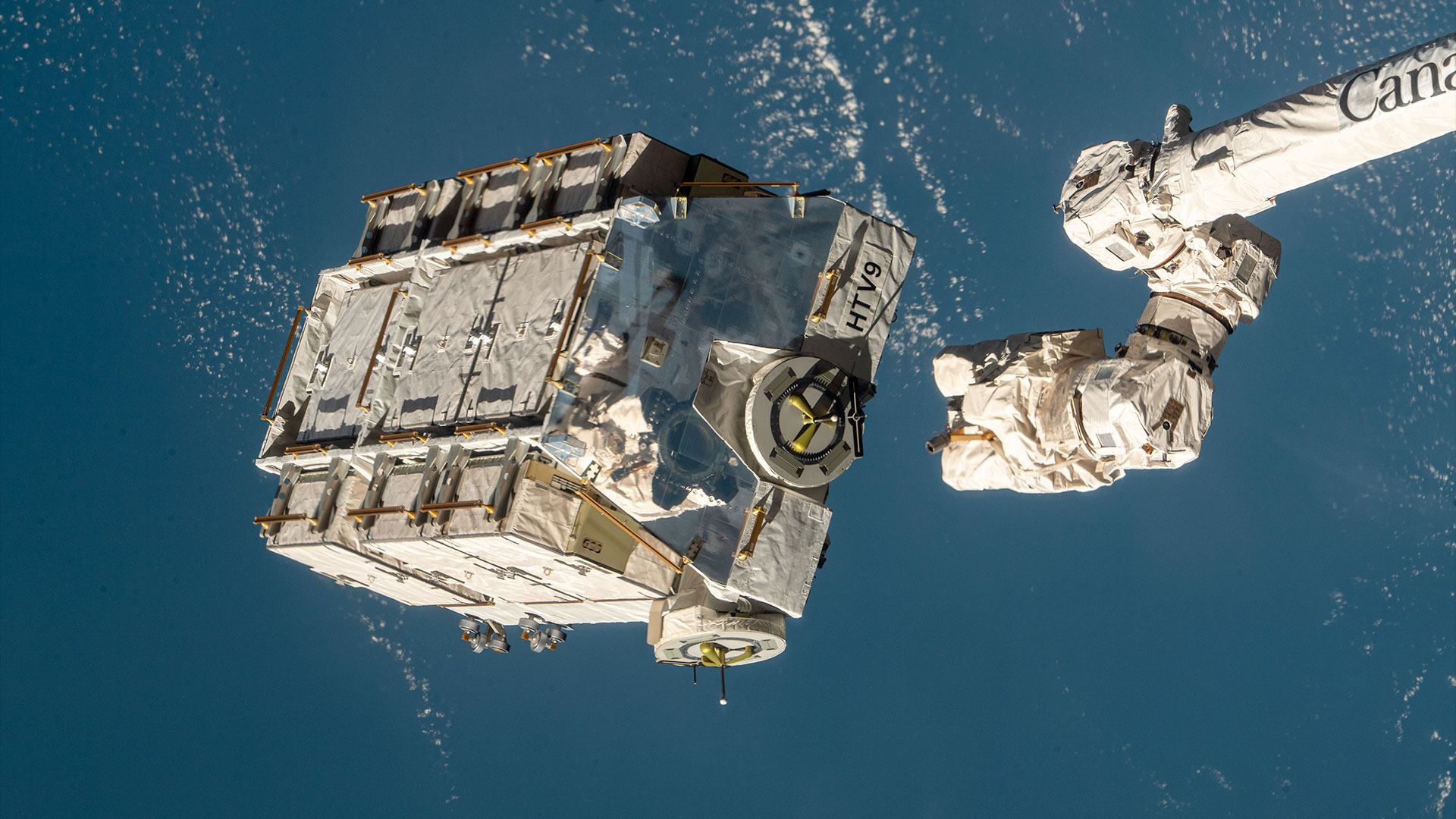

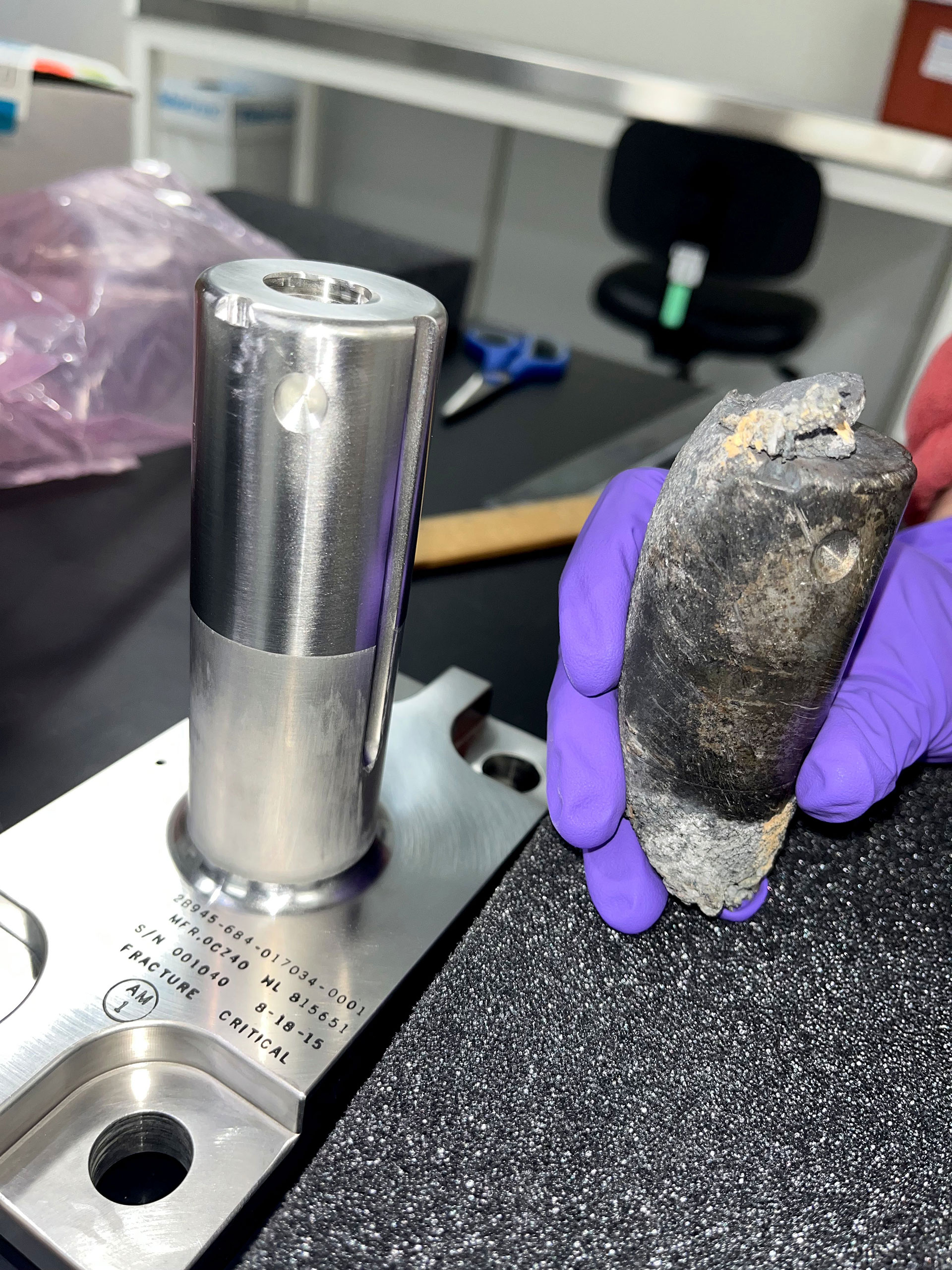

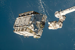

The previously unknown space object, which looks to have been partially melted and mangled, has been identified by space agency scientists as the remnants of a stanchion used to mount nickel hydride batteries on a cargo pallet after they were replaced by more capable lithium-ion units. Flight controllers then used the space station's robotic arm to jettison the pallet in March 2021, with the intention that it and its contents would burn up when they plunged back into Earth's atmosphere.

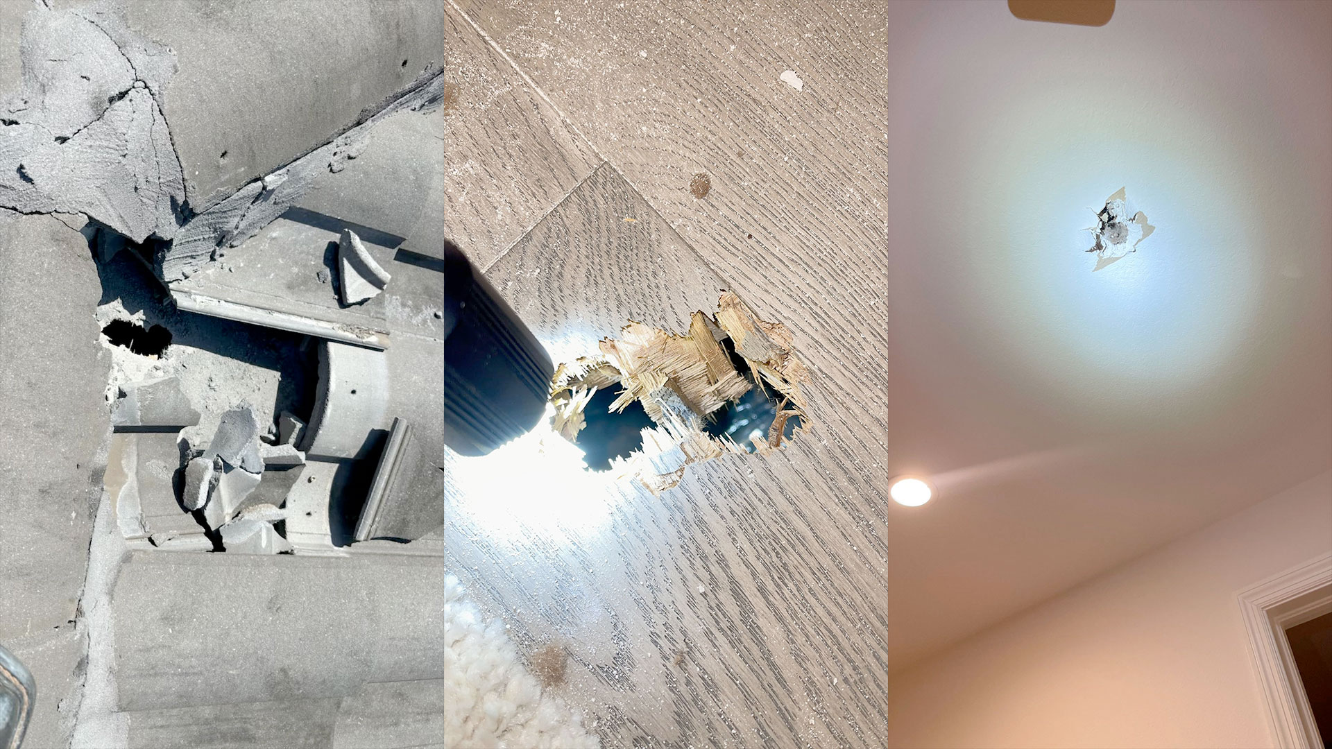

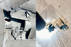

Instead, at least one 4-inch-long by 1.6-inch-wide (10-by-4 centimeter) fragment survived reentry and crashed through the roof and two floors of Alejandro Otero's home in Naples.
"Almost hit my son," Otero wrote on X (formerly X) while sharing photographs of the piece and the damage it caused to his house on March 15.
Following the advice he received in response to his post, Otero contacted NASA, which collected the debris for inspection at the Kennedy Space Center in Florida.
"NASA completed an assessment of the object's dimensions and features compared to the released hardware and performed a materials analysis," wrote Mark Garcia, a social media consultant working in support of NASA, on the agency's website. "Based on the examination, the agency determined the debris to be a stanchion from the NASA flight support equipment used to mount the batteries on the cargo pallet."
Originally, NASA had planned to dispose of the pallet in a more controlled manner, but delays to the battery upgrades resulted in the pallet having to be jettisoned. Even then, It was not expected that any parts would survive, or it any did, that they would fall over a populated area.

The 1.6-pound (725-gram) piece of Inconel metal alloy debris was a very small fraction of the approximate 5,800 pounds (2,630 kilograms) of material that comprised the pallet and batteries. It was and still is the most massive item thrown overboard from the International Space Station in its more than 25 years circling the planet.

Recovered stanchion (at right) compared with a unused unit like the type used to mount International Space Station batteries on a cargo pallet and which fell back to Earth on March 8, 2024. (NASA)
An external pallet packed with degraded nickel-hydrogen batteries is released from the International Space Station by the Canadarm2 robotic arm on March 11, 2021. (NASA)
Damage to Alejandro Otero's Florida home after being hit by debris from the International Space Station. (Alejandro Otero via X)
