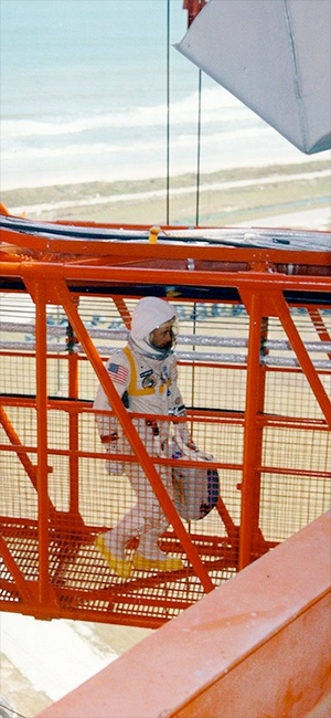

Apollo 1 crewmembers walk across a catwalk to the Launch Pad 34 whiteroom to board their spacecraft on Jan. 27, 1967. (NASA)
