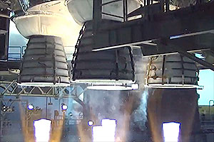

Hot fire engine test. Click to enlarge and view video in a new, pop-up window. (NASA)
Finally, at 4:27 p.m. CST (2227 GMT), the four RS-25 engines ignited. Although each had been lit before — including launching on 21 space shuttle missions; two on the final space shuttle mission, STS-135 in 2011 — it was the first time that four were used at the same time (the shuttle orbiters used three).
Among the key objectives for the hot fire was to simulate the engines performing as they would during launch, throttling up to 109 percent of rated thrust and then down to 95 percent and being able to gimbal while doing so. The first of those programmed demonstrations was about to begin when one of the engines (no. 4) indicated a failure, despite still seeming to be firing normally alongside the three others.
"We did see a little bit of a flash come from around the interface between the thermal protection blanket on engine 4 at the time where we had initiated the gimbal or there about," said John Honeycutt, NASA's SLS program manager, but added it was too soon to know if that was related to the cause of the shutdown.
