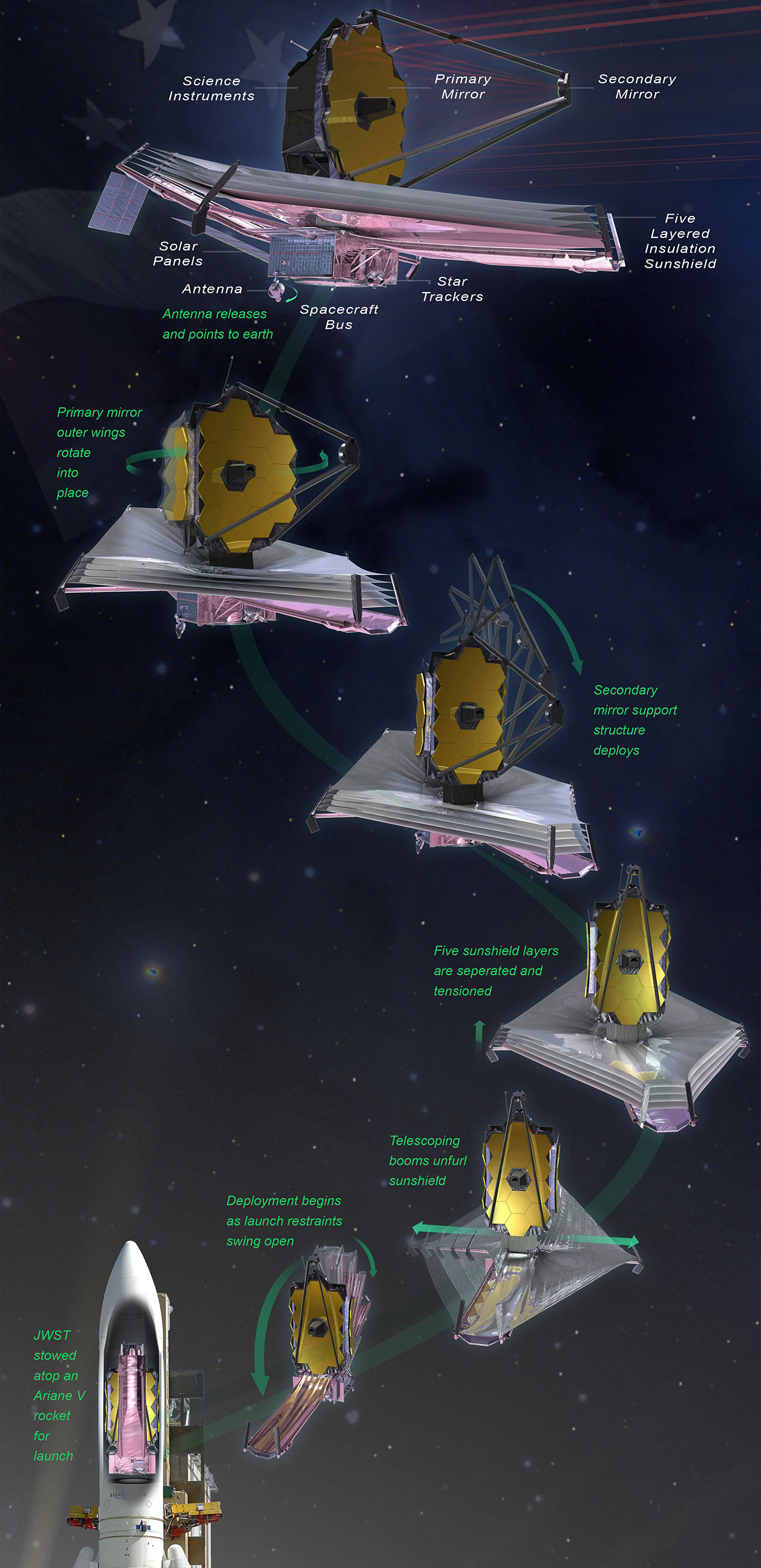

Webb's multi-step deployment was a factor of its launch. No rocket could lift off with the telescope unfolded, but even using the largest fairing available, Webb had to be compacted down from its 70-foot-wide (21.2 m) final configuration to just 15 feet (4.57 m) in diameter so it fit atop its Ariane 5 launch vehicle.
With the exception of the first two autonomous deployments — Webb's power-providing solar array and the telescope's antenna assembly — the remaining 16 components were commanded to unlatch, unfurl or tighten by team members on the ground. Their work was done without visual confirmation that all had worked as they planned.
"Adding cameras to watch an unprecedentedly complicated deployment of such a precious spacecraft as Webb sounds like a no-brainer, but in Webb's case, there's much more to it than meets the eye," Paul Geithner, a deputy project manager for Webb at NASA's Goddard Space Flight Center in Maryland, said in a statement. The sheer size of the telescope and the environment where it is located ruled out even doorbell-like cameras.
Instead, said Geithner, the team relied solely on switches and various mechanical, electrical and temperature sensors to determine their commands were successful.
Of the many steps needed to unfold Webb, key among them was the extension of the sunshield, which will lower and maintain the telescope's temperature, enabling observations in the infrared. Each of the shield's five layers had to be individually tensioned, a process that took about two days to complete.
"The team has accomplished an audacious feat," said Gregory Robinson, Webb's program director at NASA Headquarters, after all of the layers were tightened on Jan. 4. "Unfolding Webb's sunshield in space is an incredible milestone, crucial to the success of the mission."

Graphic showing the James Webb Space Telescope as it proceeds through the major steps of deployment. (Northrop Grumman)
