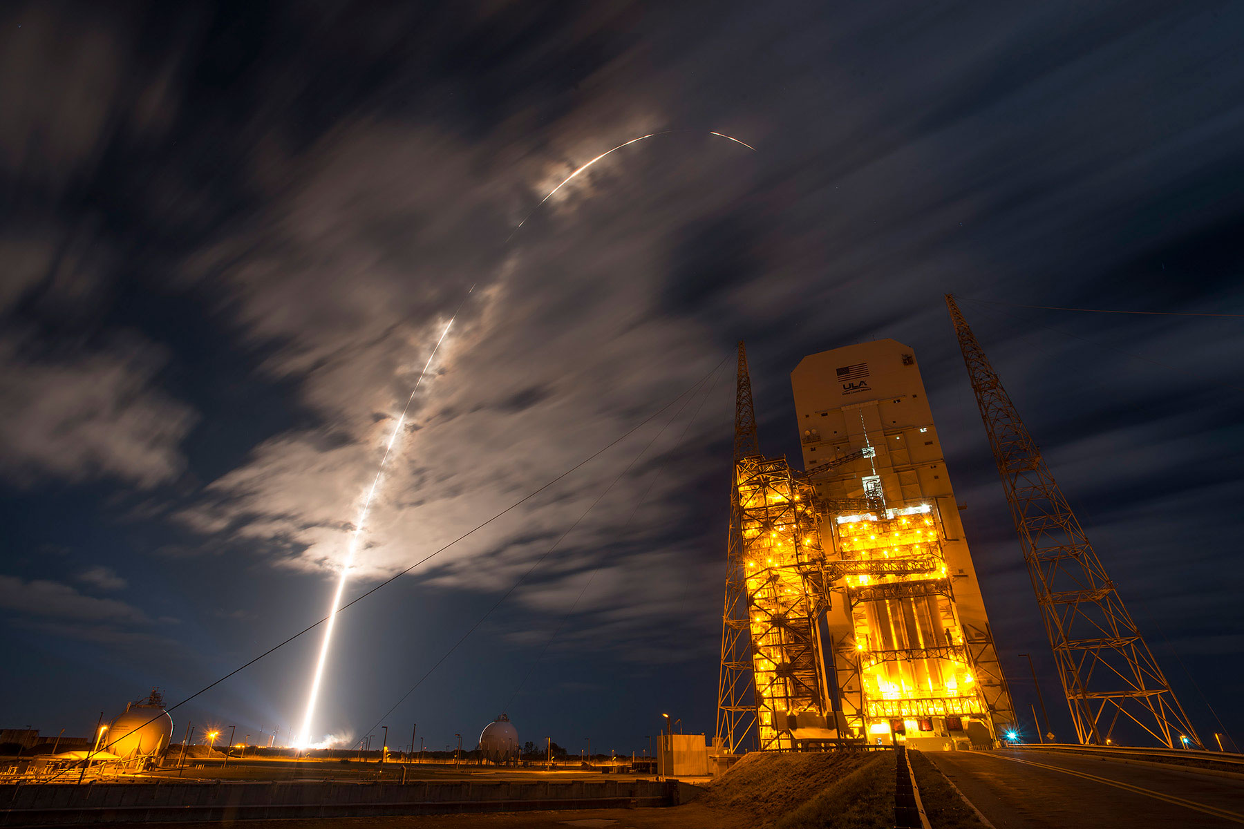

posted 03-22-2016 10:53 PM
A great start tonight for the S.S. Rick Husband! Photo credit: ULA |
