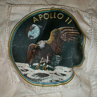

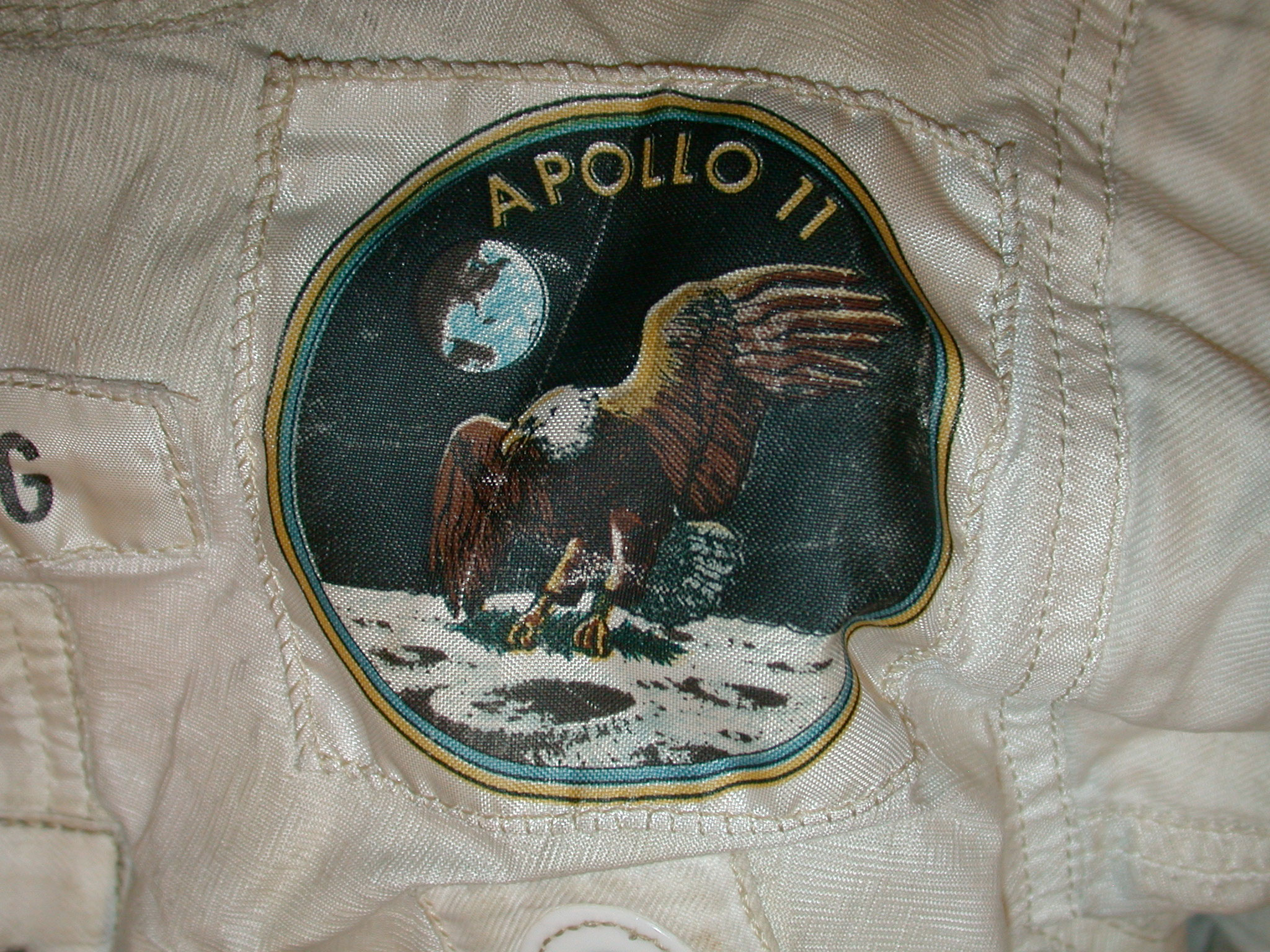

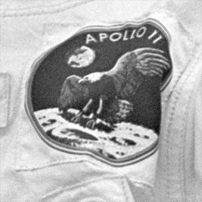

If the mission patch on Neil Armstrong's flown A7L-056 suit is the flown patch, why does the border area (stitching?) around the Apollo 11 patch look different in these pre-flight and post-flight photos?Pre-flight:  Post-flight:  |

If it is not just a difference in lighting and proximity when photographed, then one possibility might trace back to post-flight servicing.NASA had a practice of removing the patches from the suits to present to the astronauts after their mission. The Apollo 11 crew is known to have refused this gift, recognizing the historic nature of their suits. It is possible the patches had been removed before the crew's direction to keep them with their suits, and so had to be resewn on. (But that is conjecture on my part.) |

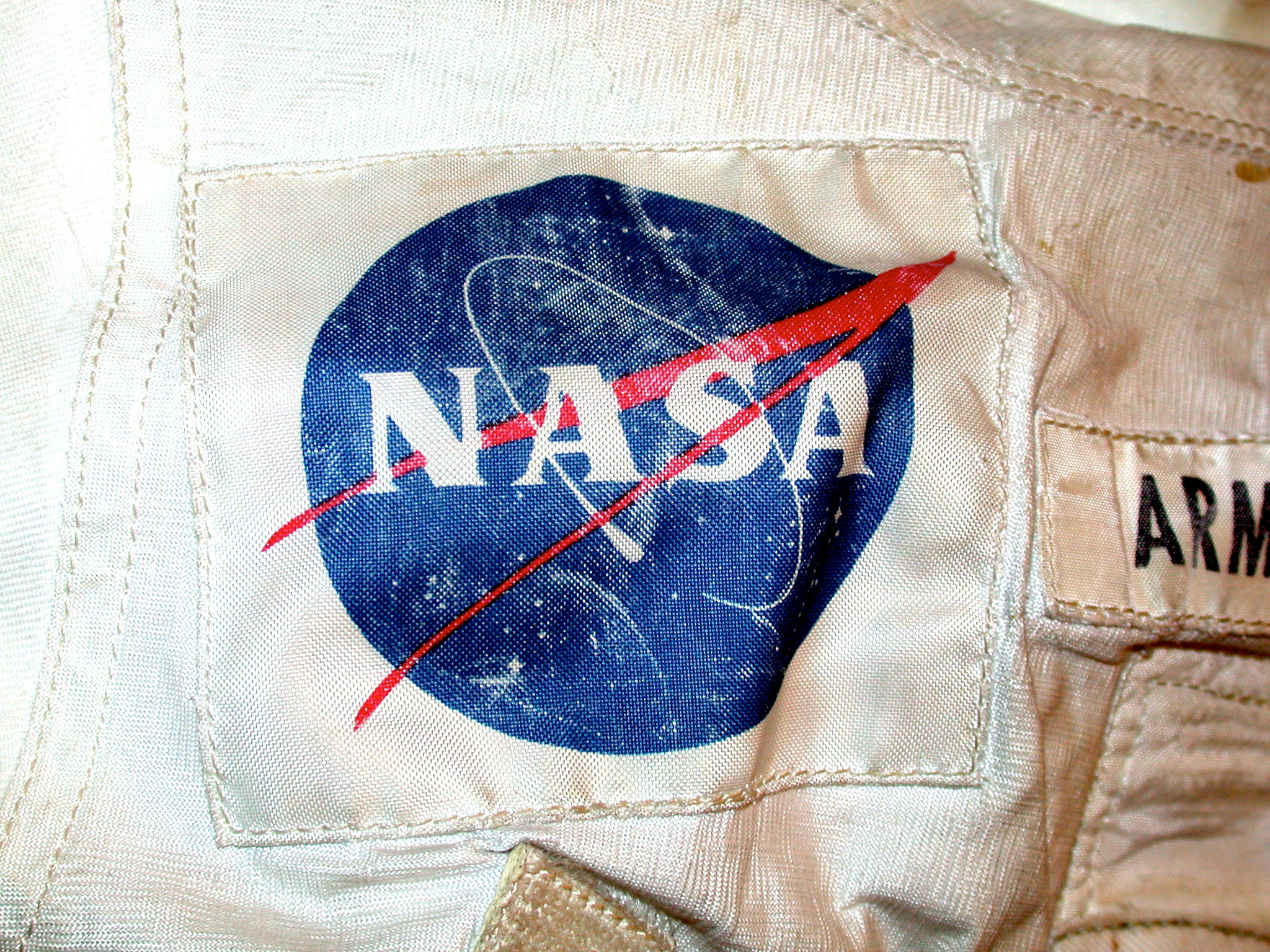

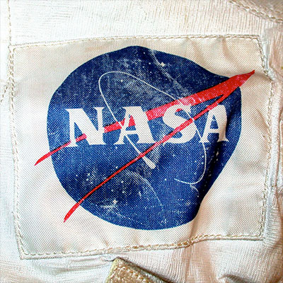

For comparison, this photo shows the border area around his flown NASA meatball patch. To me, the border area of the mission patch in the pre-flight photo looks more like this, rather than the post-flight photo. |

The pre-flight and post-flight photos of the stitching of the mission emblem patch looks the same. The best area to compare is the left side of the patch. Both the pre-flight and post-flight photos of the mission emblem patch show a diagonal stitching pattern which is different from the stitching pattern of the NASA patch. |

I have heard that the Apollo 11 mission patch was added to the suits very late pre-flight, so that might explain why the two post-flight borders look so different.Perhaps for the other missions, the NASA meatball patches were sewn on at ILC, and the mission patches were only added after the flight crews were announced. |

The NASA vector patches were sewn to the outer layer of beta cloth using a sewing machine during suit manufacture, before the multiple TMG layers were put together. That is why the vector patches have a single straight stitch around the edge. All mission patches are hand sewn to the suit after the suits are completed and suits are successfully prepped for flight. Since the TMG is already together and they don't want to stitch thru the multiple TMG layers (as stitching the multiple TMG layers together reduces the thermal insulation capability), the mission patches are hand loop-stitched to just the outer layer of beta cloth. Not an easy task. That is why the mission patches have the diagonal stitching around the edge. The mission patches also have straight stitching along the edge to hem it before it is attached to the suit. I believe the pre-flight and post flight border stitching is the same, the preflight picture is slightly blurry and more difficult see the stitching details. |

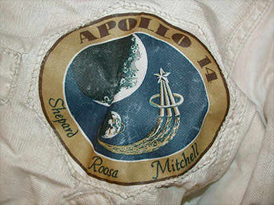

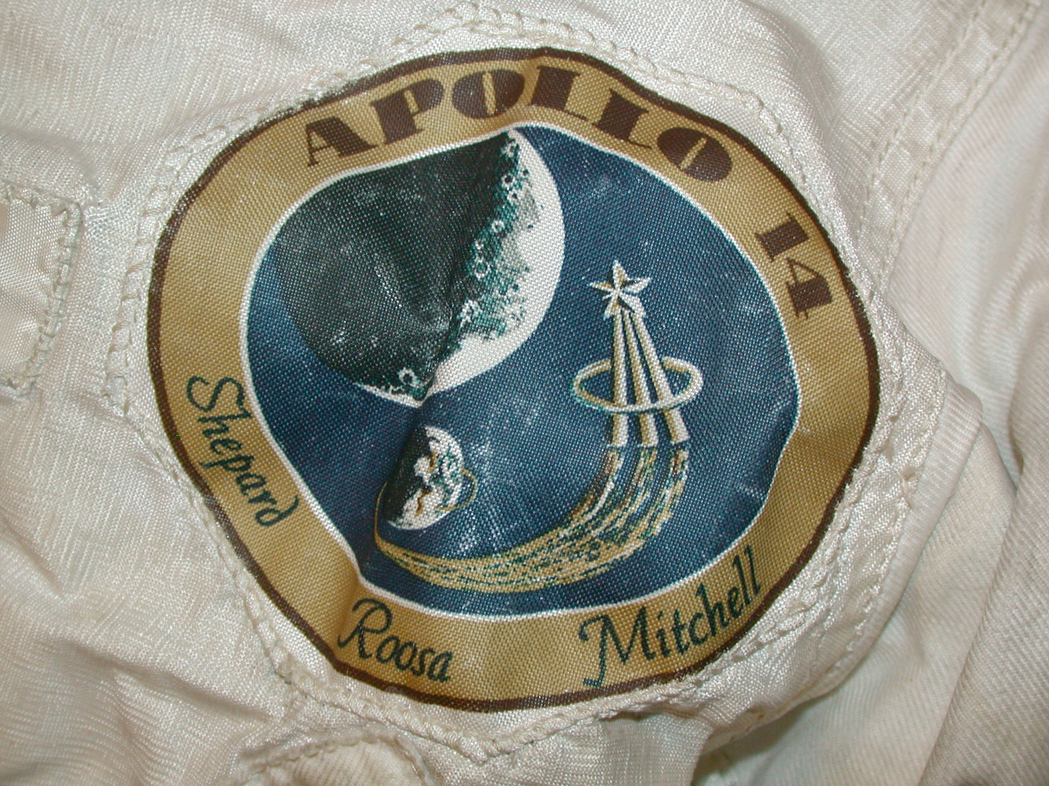

This is a post-flight photo of the mission patch on Ed Mitchell's lunar suit. It shows the same type of diagonal stitching, but it probably isn't the flown patch. |
