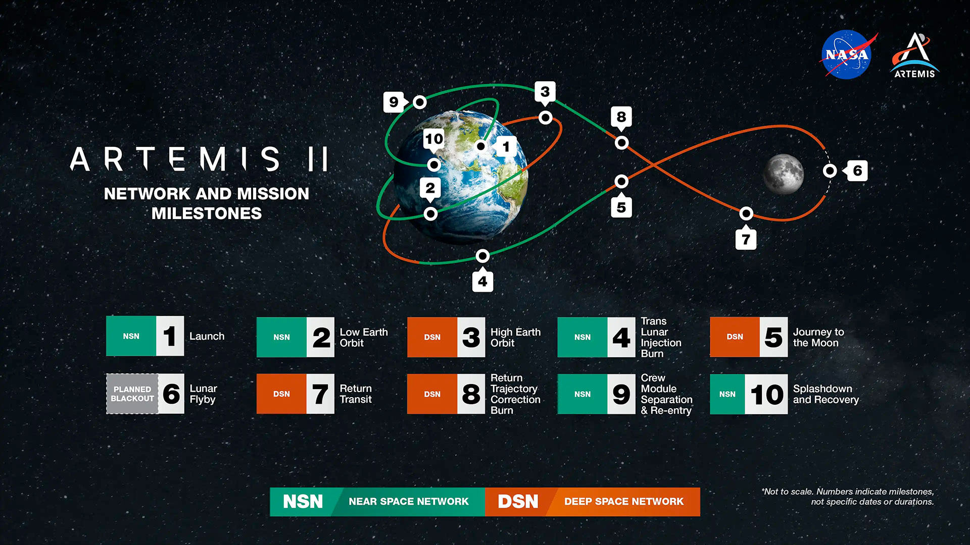

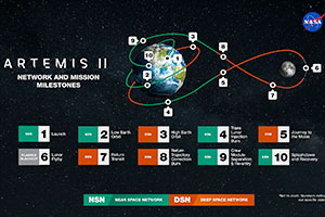

For most of the Artemis II mission, communications between Integrity and NASA's Mission Control in Houston is being handled by either NASA's Near Space or Deep Space networks. During the flyby, any imagery being broadcast live to Earth will be through the latter, which relies on transmissions to radio antennas located in California, Spain and Australia.
Integrity is also carrying an experimental optical communication system that uses a laser (infrared light) to transmit data at a higher rate than radio waves, allowing for larger video and imagery files to be transmitted back to Earth quicker. Prior to the flyby, the demo had successfully transferred more than 100 gigabytes of data collected during the mission thus far.
The optical communications system, though, can only be used at night as sunlight can cause interference and it is subject to other limitations, including being pointed in the wrong direction while Integrity's windows are focused on the lunar surface.
So all of the live imagery from the flyby, as well as the telemetry from the capsule, crew communications with Mission Control and more has to all be directed through the same radio direct pipeline.

Graphic showing the communications networks that the Artemis II mission is using to send vital data down to flight controllers on Earth. This includes astronaut communications, mission health and safety information, images, video and more. (NASA/Dave Ryan)

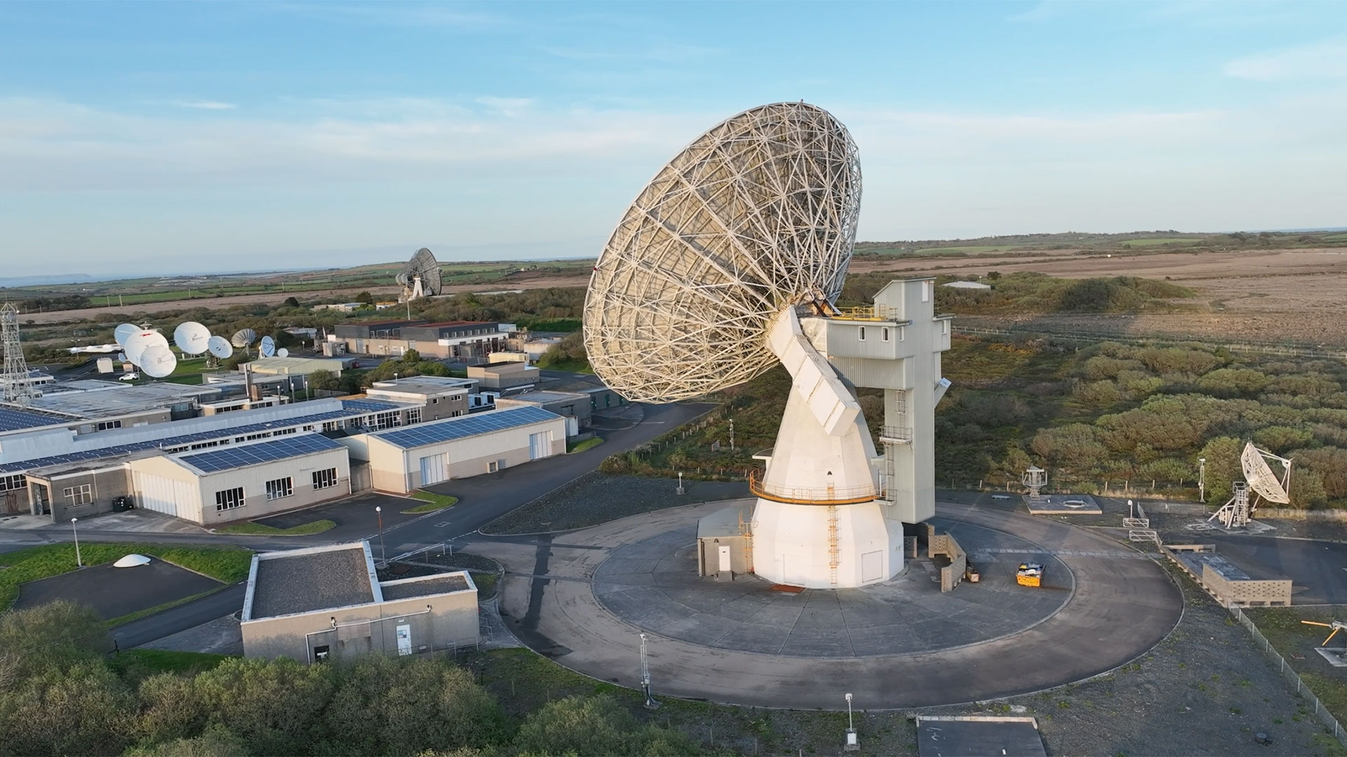

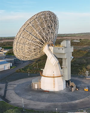

Intuitive Machines' space network connects space and ground via partner sites like Goonhilly and the company's controlled locations, offering enhanced connectivity. (Goonhilly Earth Station Ltd.)
