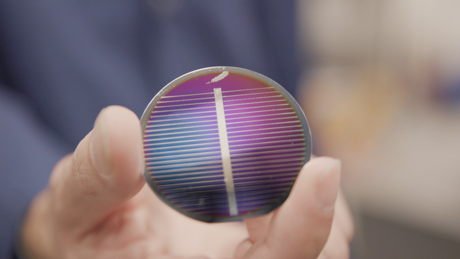

Since 2021, Blue Origin has been making solar cells and transmission wire from regolith simulants.
To make long-term presence on the Moon viable, we need abundant electrical power. We can make power systems on the Moon directly from materials that exist everywhere on the surface, without special substances brought from Earth. We have pioneered the technology and demonstrated all the steps. Our approach, Blue Alchemist, can scale indefinitely, eliminating power as a constraint anywhere on the Moon.
Above: Blue Origin manufactured this working solar cell prototype from lunar regolith simulants.

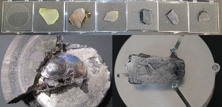

Using regolith simulants, our reactor produces iron, silicon, and aluminum through molten regolith electrolysis, in which an electrical current separates those elements from the oxygen to which they are bound. Oxygen for propulsion and life support is a byproduct.
Our process purifies silicon to more than 99.999%. This level of purity is required to make efficient solar cells. While typical silicon purification methods on Earth use large amounts of toxic and explosive chemicals, our process uses just sunlight and the silicon from our reactor.
For protection from the harsh lunar environment, solar cells need cover glass; without it, they would only last for days. Our technique uses only molten regolith electrolysis byproducts to make cover glass that enables lunar lifetimes exceeding a decade.

Above: Materials such as iron, silicon, glasses, and ceramics are extracted from our Molten Regolith Electrolysis (MRE) reactor.
