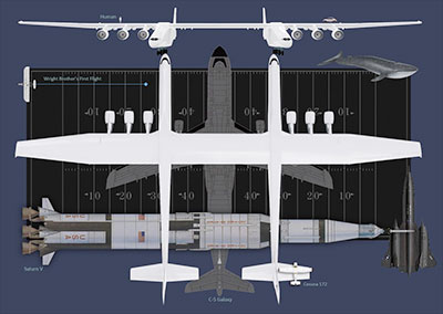

This aircraft looks like it will ultimately have a 747 wingspan practically.
Not even close — it will be much bigger.
It will use six 747 engines, have a gross weight of more than 1.2 million pounds and a wingspan of more than 380 feet.
By comparison, the Boeing 747 has a wingspan of only 211.5 feet.
Okay, so it will have a wingspan almost twice the size of a 747. Good grief, this thing is going to be a MONSTER.

I think folks are overlooking one factor — it's not just the length of the runway, but also the width.
The wingspan on this bad boy is 385 feet. The SLF is 300 feet. The Stratolaunch CGI showing it launching from the SLF shows the wings extending beyond the edges of the runway.
That's what will truly limit potential sites.
