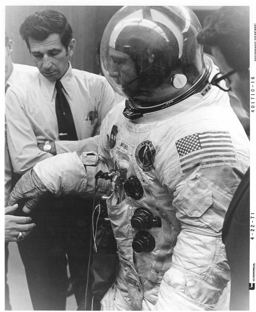

After the mission, his EVA suit was taken to ILC for post-flight testing to study the problem. There, Mitchell wore his dusty suit, helmet and gloves. The suit was pressurized. (I don't know what date that was.)
The mission report has this about the post-flight testing of Mitchell's right glove:
Purpose: To investigate operational difficulties experienced with the Lunar Module Pilot's pressure garment assembly.
Tests performed: Inspect gloves for possible wrist cable damage. Perform pressure garment assembly evaluation of suited pressure with Lunar Module Pilot.
Results: No wrist cable damage was found. The problem was duplicated in a test with the Lunar Module Pilot suited. Test not complete.

Here is a description of Ed Mitchell's lunar suit problem from "Lunar Outfitters, Making the Apollo Space Suit" author, Bill Ayrey:
During the Apollo 14 mission, Edgar Mitchell had just pressurized his suit in the Lunar Module prior to opening the door for his EVA. He radioed back to Houston to say that he thought one of the restraint cables in his right glove wrist area may have broken because his hand was being somewhat pulled down and to the right. After consulting between NASA and ILC engineers, a decision was made to continue with the EVA. All went well during his time on the moon, but the EVA gloves were returned to earth for evaluation.
Mitchell's suit and gloves were sent to ILC in Dover. DE., and a month or so later, Edgar Mitchell flew to ILC and got back into his suit (now coated in Lunar dust) and demonstrated the problem he experienced in the presence of engineer Richard Pulling and others. It was determined that the cables were not installed onto the wrist hardware symmetrically, and as a result, the glove was being pulled to the side.
The date on this ILC photo of Mitchell is April 22, 1971.
