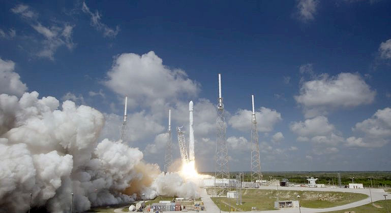

SpaceX's Falcon 9 lifted off at 10:29 a.m. EDT (1429 GMT) on Wednesday (June 15). From SpaceX on Twitter:
Second stage and satellites now in nominal coast phase.
(The video feed cut off before it was clear if the first stage successfully landed on the droneship.)
