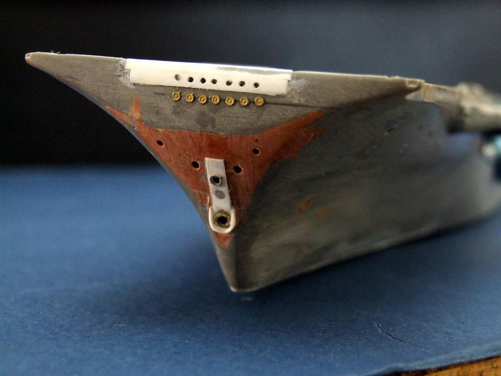

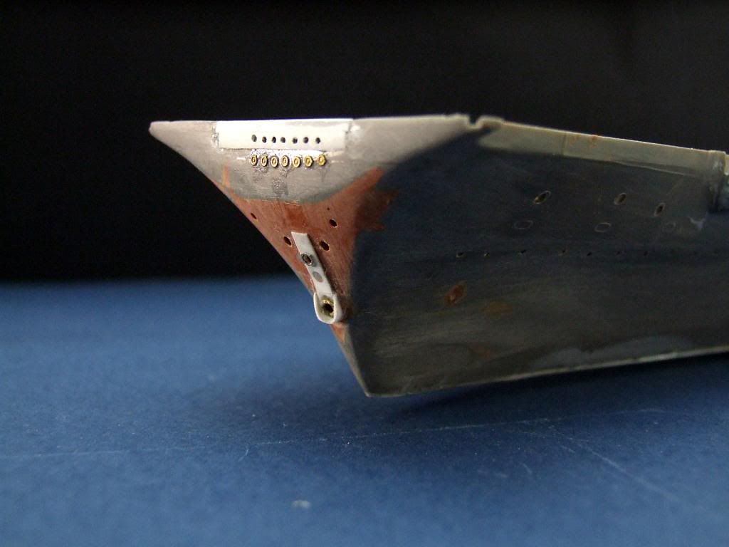

More pics on the modifications done to the Bow, Stern and Port side of the hanger done by Lou on the Revell USS Hornet + 3Bow before:
alexbaja Member Posts: 448 From: Naxxar, Malta Registered: Dec 2010
posted 04-09-2014 05:56 AM
Bow After:

posted 04-09-2014 09:35 AM
Looks great the extra details!!! |
