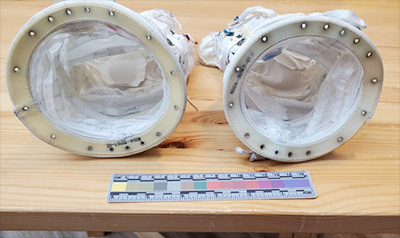

The actual restraint layer has those holes already engineered into the design to allow fasteners for integration of a sealed restraint/bladder layer interface to the wrist bearing.
Robert Pearlman Editor
Posts: 48865 From: Houston, TX Registered: Nov 1999
posted 08-14-2022 10:16 AM
Ah, yes. It had been a while since I looked at a restraint layer. Using one of your own photos as a reference:
It would still like a good idea to use a mockup for the purposes of designing and testing a display like this before installing an example of the real thing.
