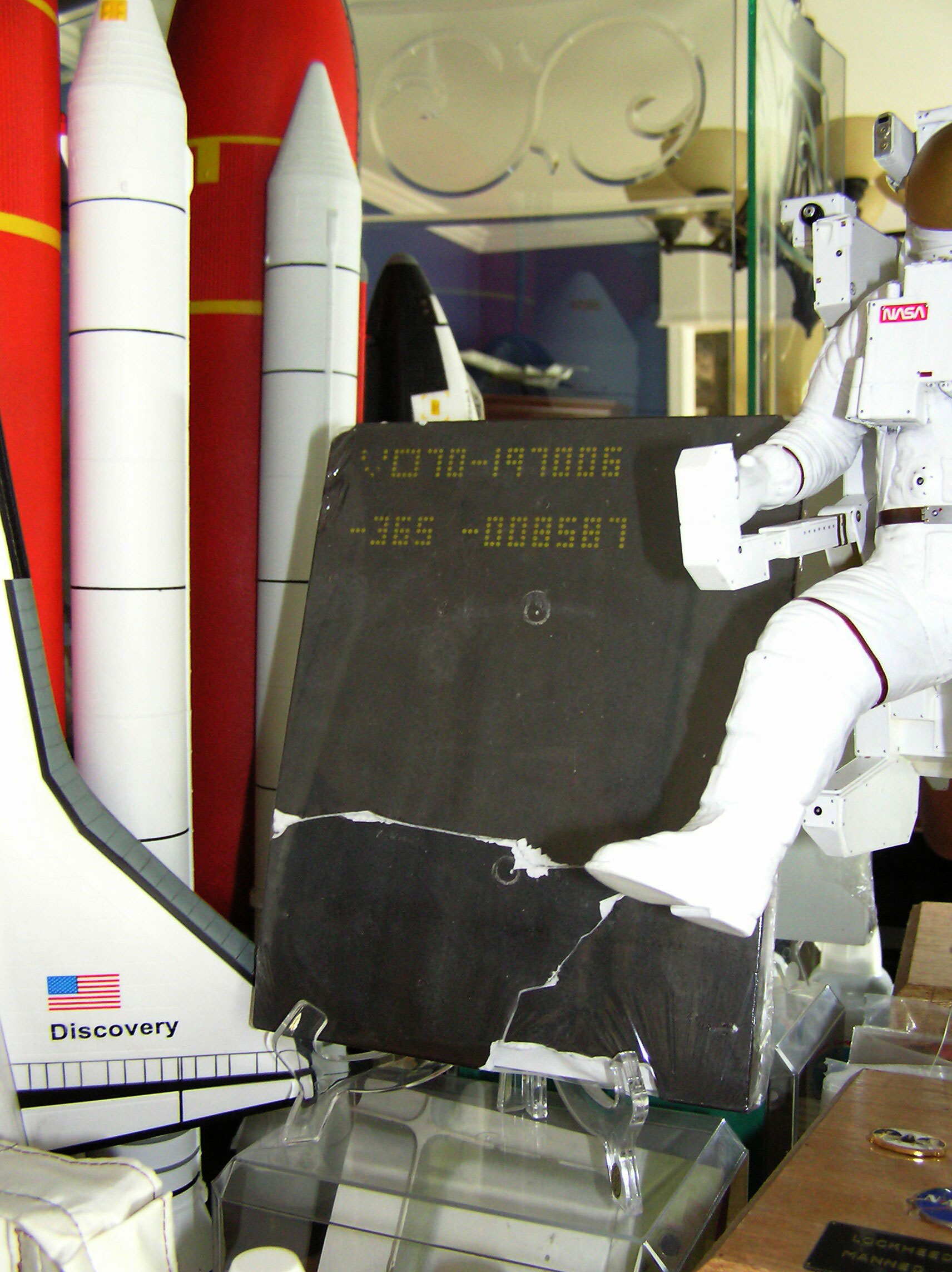

Our tile is broken in about four places and all that was keeping it whole was the felt layer on the back. We cut cardboard to match the size, placed the tile on the cardboard and then wrapped it in one layer of stretched plastic wrap. No more loose fibers and it is now easy to display. |

If you pull the plastic wrap tight it basically the same as shrink wrap and you can control the pressure. As long as the tile is for static display there should be no abrasion issues.As pictured here, the tile is sitting on a clear plastic plate holder. You can pick those up at most craft type stores.

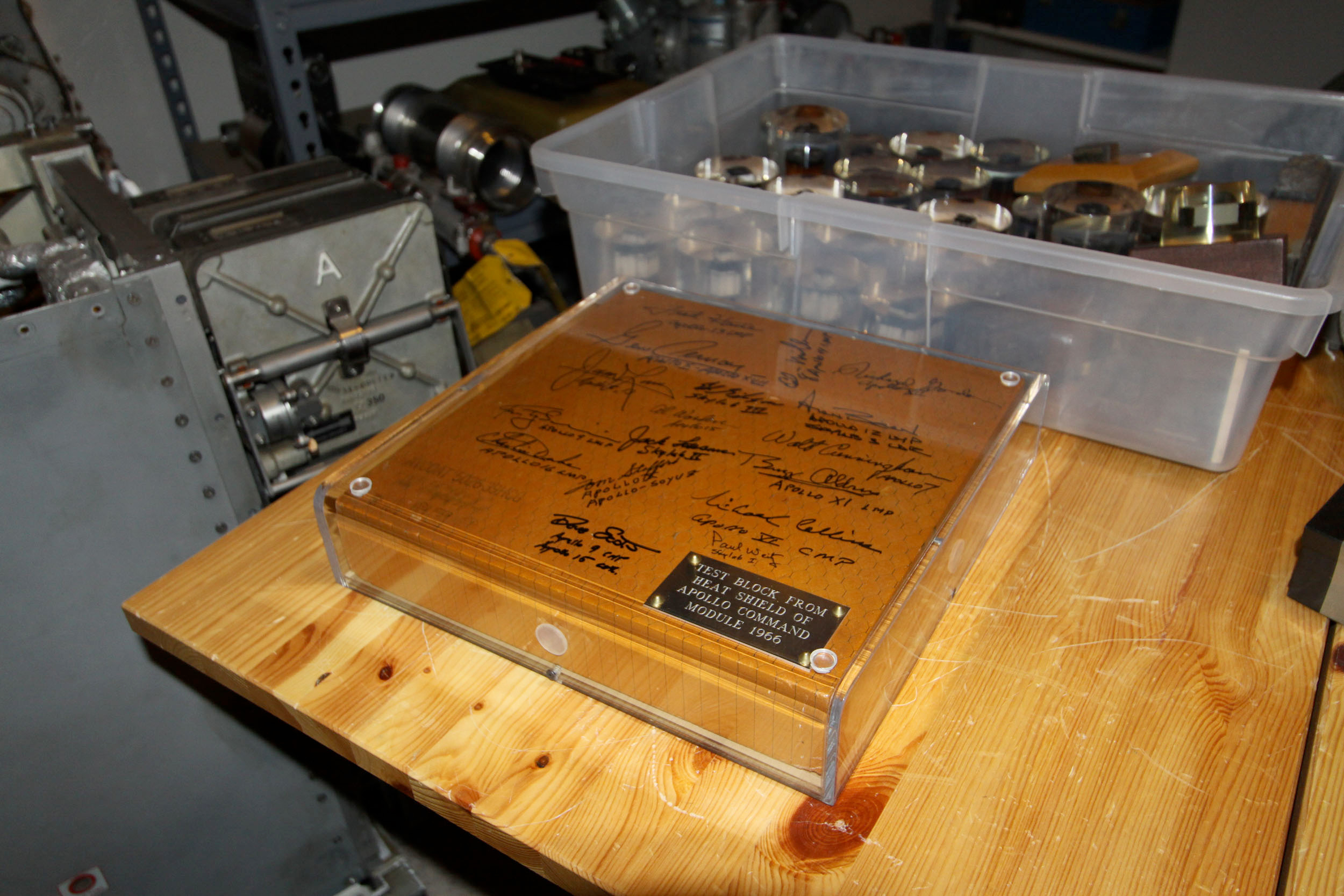

Custom casing is also an option. Quarter-inch UV rejecting lucite sheeting and soft pads were used to encapsulate this Apollo TPS artifact. |
